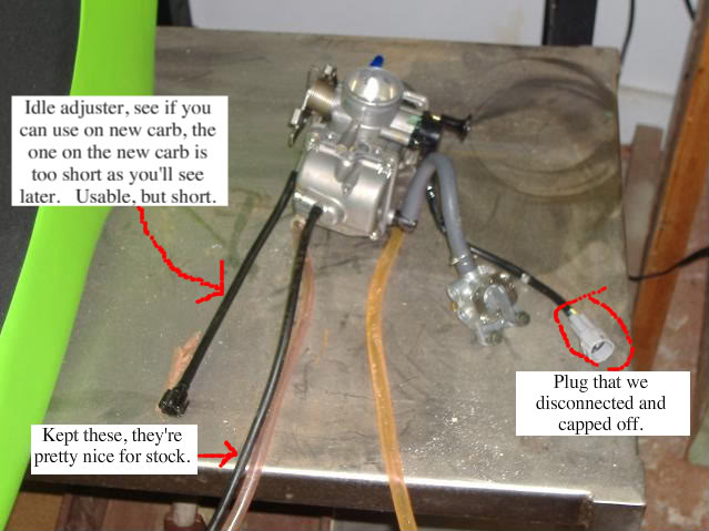

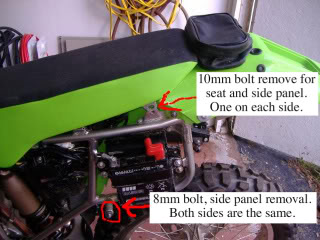

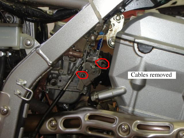

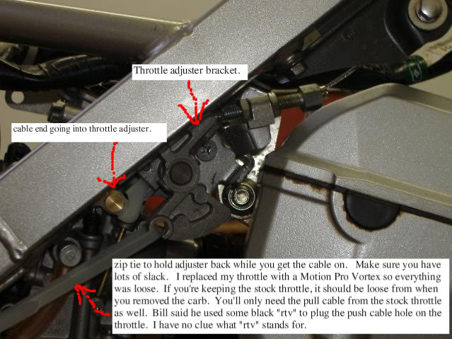

I replaced the stock carb and throttle on my 07 the other day with a Bill Blue TM-33 carb and a Motion Pro Vortex throttle. I took some notes/pics. I've been trying to post these in one post for a couple of days without any luck, so we'll see how this goes.

WOW you put a lot of effort into that. you've really taken a lot of theunknown out ofit for everyone. I'm surethe new guys here will appreciate all your work.
Old Jun 12, 2008 | 01:38 AM
Default RE: TM-33/Motion Pro Throttle install with pics
Excellent write-up! Extra points for annotating the photos themselves. That's one way to get around this forum's apparent post size limit.
