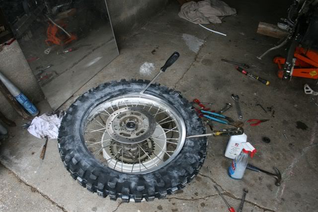

When I ordered my new 606 I ordered some tubes and tire spoons too. Well the tire came in 2 days, the tools etc must have shipped out of a different warehouse. The tire came last friday (halloween) and I was planning on riding in a Dual sport event that Sunday. There is no question, the tire is getting put on. I hate to do it but I'll have to use my trusty, big, nasty screwdrivers.

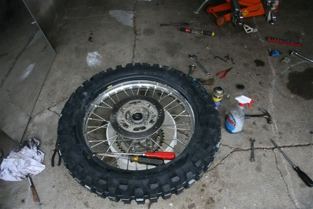

I don't know what they put on the tube when they put this thing together, but it didn't wash off easily. That stock tube felt pretty thin too.

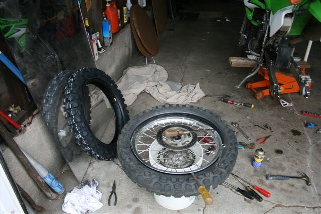

Ok ,5gal bucket, screwdrivers, windex, crap all over the garage floor. Let's get the new one on there.

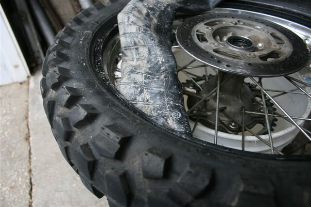

Tube in, baby powder everywhere, watchout with those screwdrivers.

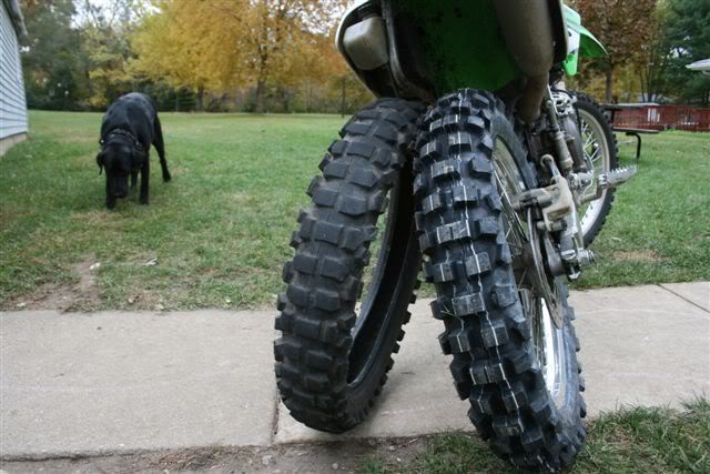

Worked great. Happy that the tube still held air.
The new one is the Dunlop 606 120/90-18, the old one is the Dunlop 603 4.60x18. The overall width of these two tires is almost exactly the same (the 120/90 should be wider thean the 4.60, but I can't see it ) . Definitely room for the 130mm wide Dunlop 606's on these bikes. Rode the Dual Sport event, and had a blast (I plan on posting that up soon). I think I would have really had some trouble if I hadn't gotten the new tire and got it on before the ride. Thanks for the help. Dan
