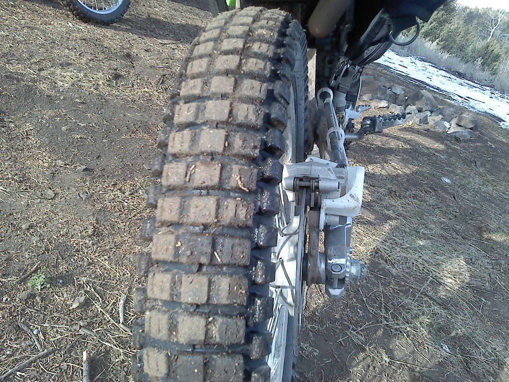

Dual sport tires are a compromise and a sacrifice. IMO, get tires that perform where its most important for your riding preference. Then learn how to deal with them elsewhere. For me, dirt is more important so a TM II up front and a trials tire on back are what's on now. Could have used some studded snow tires yesterday

Originally Posted by Klxrelic
Ummm...sure.... still alive after three Trackmasters and over 10,000 miles of using them tho. I don't pretend the KLX is a racer on the pavement ....seems to help.
Good to know...have one in the garage waiting for install as soon as this trials tire gets too tired. It's close.
I find with the TM's that what you gain in dirt ya lose a percentage on street. Keep the speeds conservative on the winding stuff. If starting at an intersection that requires a turn.....don't crack it to her.....it will slide out. A quick roll back on the throttle regains composure. Braking....not a big deal. Rear doesn't provide much anyways. Highway speeds.....no problem. They do tend to get noisy on the pavement as they wear.I get around 5000 kms....3500 miles out of a TM. Dont be much left.But the traction I get in wet grass, woodsy stuff is well worth the little extra conservative street riding......
Just gotta do more trail riding.....which is what the KLX is mean to be.
