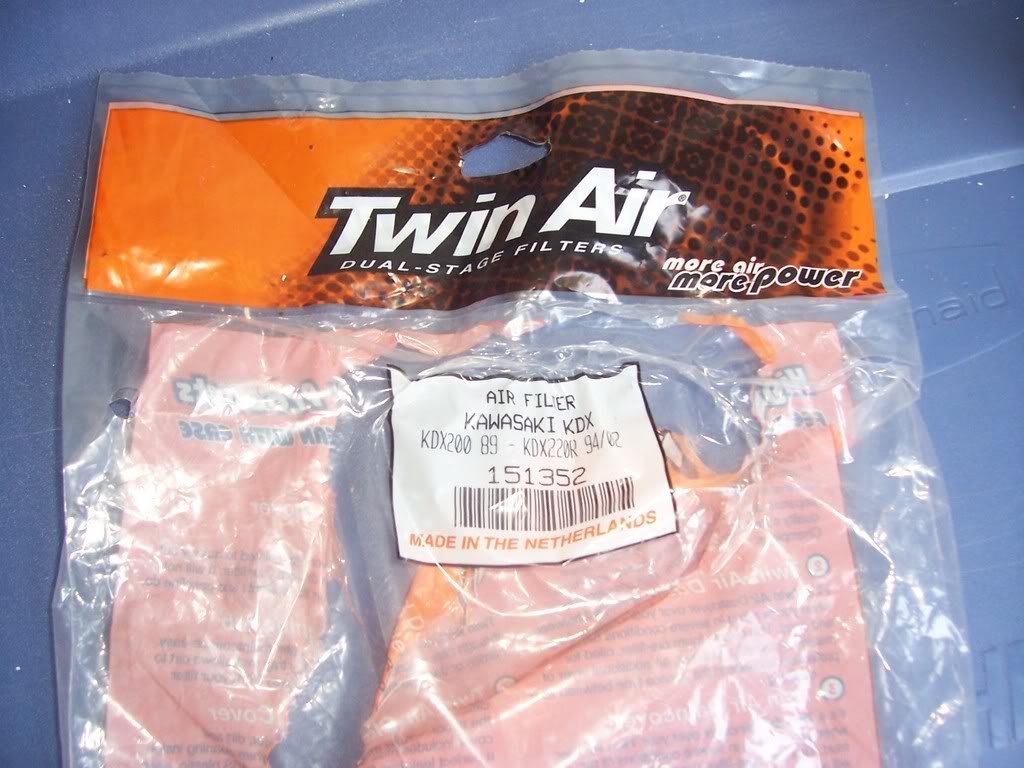

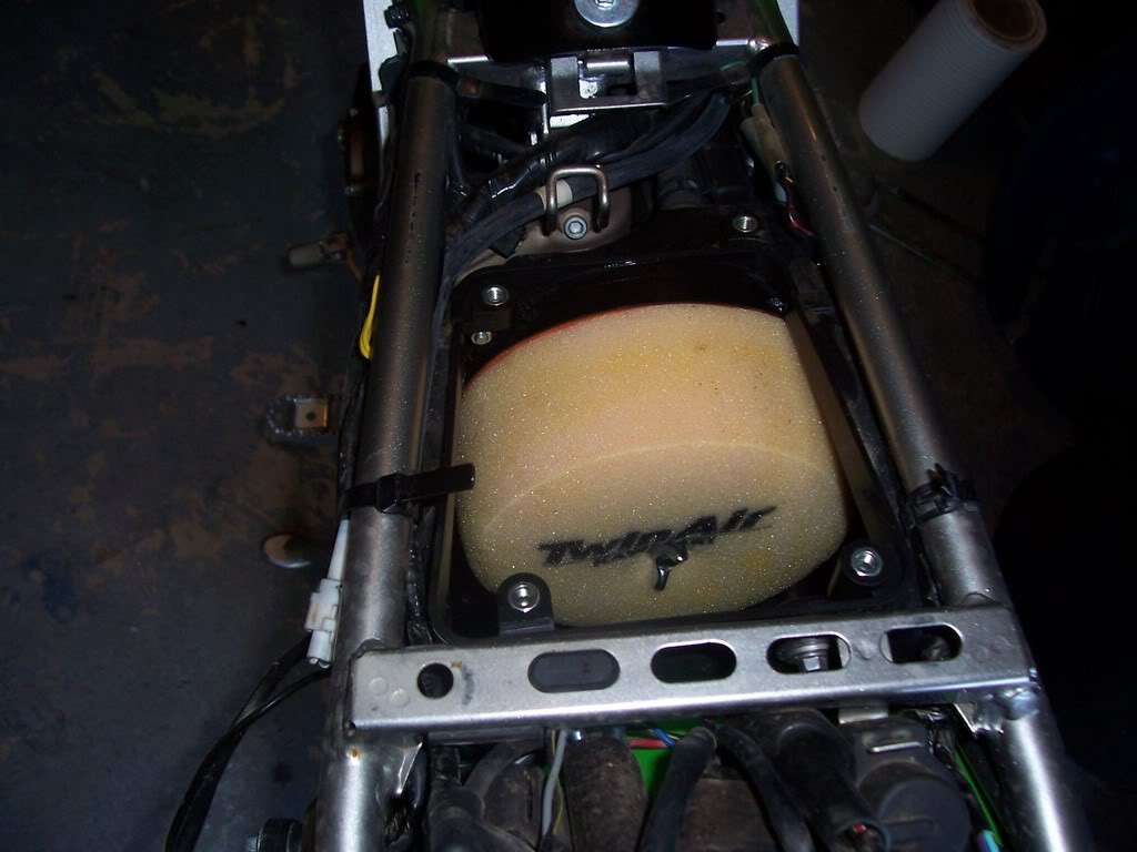

Oh yeah... Here's a pic of the Twin-Air installed in the KLX and the part number. The KDX and KLX have the same air filter.
M
