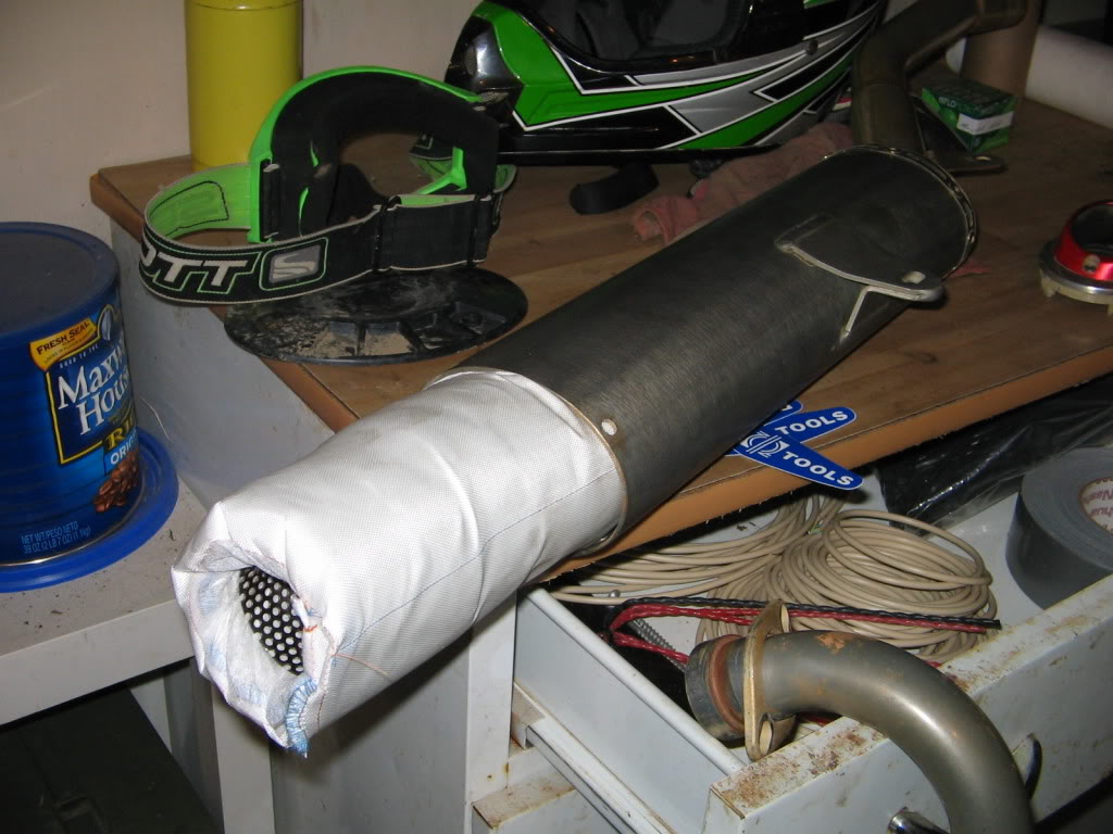

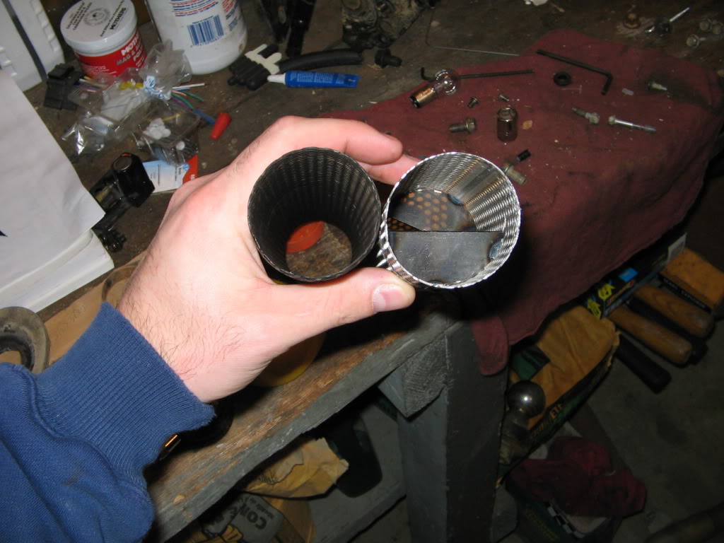

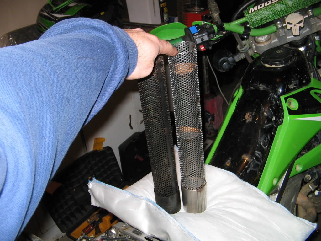

The big gun comes with the race core, and vortex insert, i liked it a little less quiet with the vortex insert but it didnt run as good, so i got the quiet insert for mine, its still not quiet but runs better than the vortex insert but its not as loud as the race core.

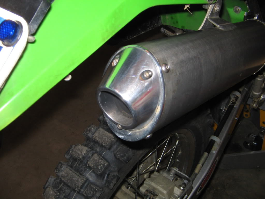

i also took the red of the end of mine
