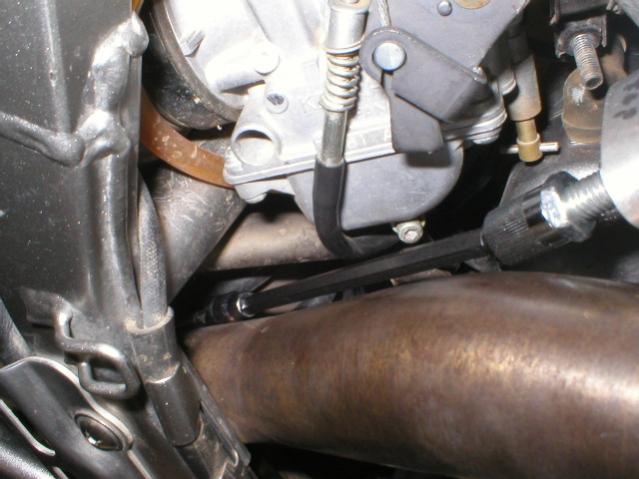

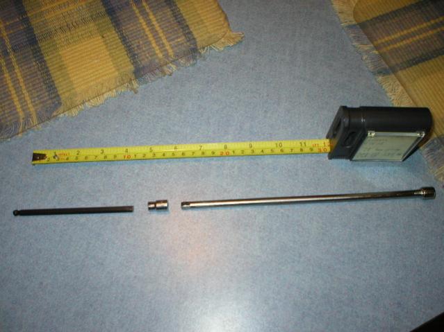

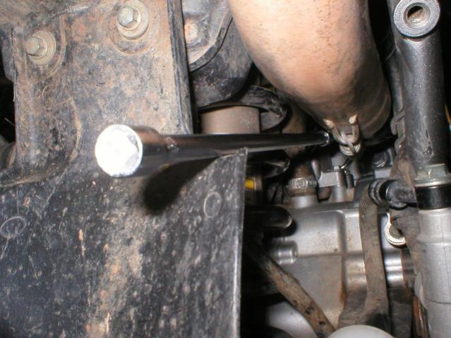

Highbeam, I think the slight noise you hear during warmup is fairly normal with the manual tensioner. Adjusted properly, the noise goes away when warm. On getting easy access to the adjuster with the engine running, I used the setup pictured here. No burnt fingers with good, finite tuning. That's 1/4" drive stuff in the pic, and the extension is a wobble joint style...though I think a straight joint model works almost as well.

Your pictures are actually printed on the instructions mailed with the tensioner. I have no trouble accessing the adjuster bolt for adjusting, it is the installation allen bolts, the 4mm ones, that caused me trouble with my big paws. That guy back between the carb and the tensioner is a challenge.
Good to hear that I should expect some noise when cold that goes away when warm, that's what I have right now. Perhaps a bit too much cold noise though so I'll snug it up one increment.
