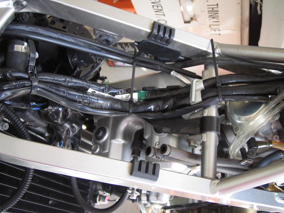

Hi mate. The cables are very tight under the stock tank and have to be 'just so.' Have a look there and see if the problem goes away when the tank is removed. I had the same issue the first time I had the carb' off. I referred to the digital photo I took before disassembly and then put the cables back exactly the same. Success. They are tight between the frame and the tank, but if located correctly there will be no binding and the throttle will return without issue, even on full lock, left and right.

This image may help.

You champ, yep I had the cables across next to the loom which may mean that the pull cable had too much on it.
