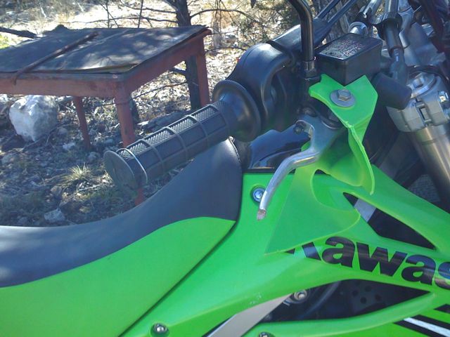

I dropped the bike on the throttle side going about 2 mph after the front wheel slipped on some gravel. Somehow the bike did not get a scratch on it except breaking the brake lever and tearing up the grip. The throttle really slammed hard on the asphalt. It looks like some plastic is cracked on the inside of the grip on the end. How tough is the throttle mechanism? It still works but I am wondering how bad the real damage is to the throttle. Should I just keep using it or get it fixed to prevent it from screwing up on another trip?

IF it turns freely it is fine. A set of guards will prevent that. I do think the throttle assembly on this bike is pretty mick. I am thinking about an after market one at some point.

After a friend dumped my bike in my driveway, destroying the left "bug guard" and bending the clutch lever the first mod done to my '07 was to fit a pair of Tusk D-Flex guards, which later saved my throttle controls and brake lever after another friend (OK, I have clumsy friends..) ran the bike off a trail and into a drainage ditch.
You have lots of choices for real handguards and I suggest you get a pair soonest. As for the throttle, I'd ride the bike (oh so carefully) for a few days to see if it still works properly. If not, replace it, just after you fit the guards....
