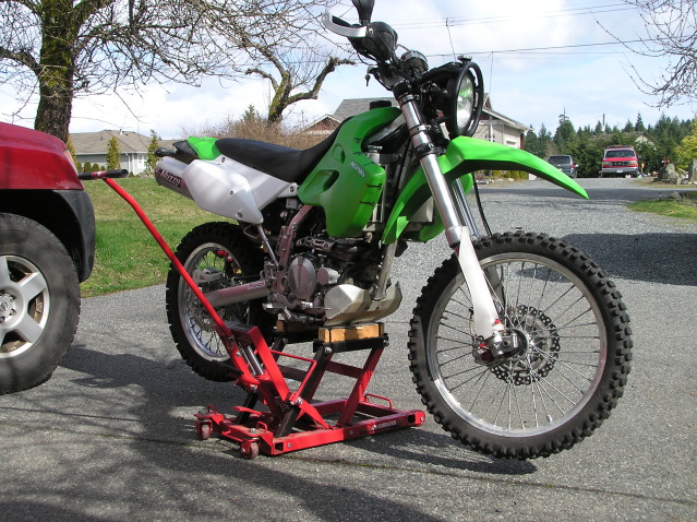

Removed rear wheel and swing arm greased all bushings and bearings
Re valved shock to match forks
Removed forks and checked fluid level
Checked front wheel bearings and seals
Installed new front brake pads
Adjusted valves and installed a new gasket
Installed Kreiger cam chain adjuster
Installed 06/07 shifter star and new 14 tooth sprocket
New drive chain
Replaced fuel lines
Removed petcock installed a quick release on fuel line for easy tank removal
Leaned out carb and drilled idle circuit
Repacked the muffler
Installed brake and shifter anti snag cables
Installed a new 3" longer clutch cable
Still need to install new clutch plates and springs.
Got new tires
New riding boots and knee armour.
That is about it.
I took her for a spin today and she feels goooood!

I made the anti snag system (***) for my bike today.
Repacking the silencer changed the sound to a really nice deep throaty thump.
