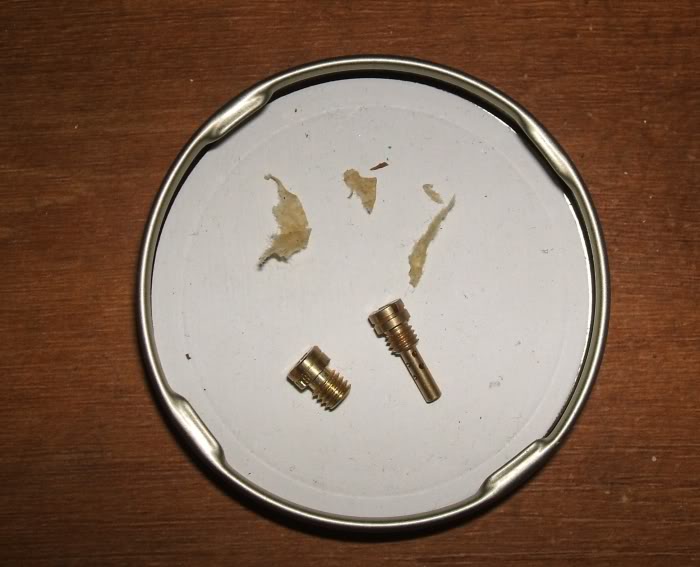

Welcome to the site Fishfinder! My left fork seal had a leak too when I first got the bike. I didn't notice it until a day or two after having the bike home.
I dreaded taking the bike back to the dealer because it was prime riding season when I got the bike and I knew that they would have it for awhile. I decided I'd tackle it myself.
I pulled the dust seal down out of the way and tried the 35mm film trick of sliding the film up under the seal to see if I could work out some dust or something. No luck. It still leaked.
Attempt number two I didn't mess around. I took the fork leg out of the triple clamps so I could turn it upside down. I used a feeler gauge to reach way down under the seal and sprayed carb cleaner in it while I worked the feeler gauge around the fork tube.
Well, guess what? There was some kind of waxy packing paper that I got out of there. It wasn't a lot, but it doesn't take much at all for a seal to not seal. [&:]
Here's a picture of the debris that I got out of there. The jets are shown for scale.
I'm not sure just how much fluid I lost when I had the leak. I think I'll drain and replace the fork oil when it gets colder around here. That way I'll know that I have the right level in each fork.
Good luck on yours! Mine has not leaked, seeped or otherwise misbehaved since I got the crud out from under the seal.

Man that sucks, at least you got that stuff out of there... im glad mine havent leaked... but i think i would have taken a leaky seal on the fork for the problems i have had..... [>:]
