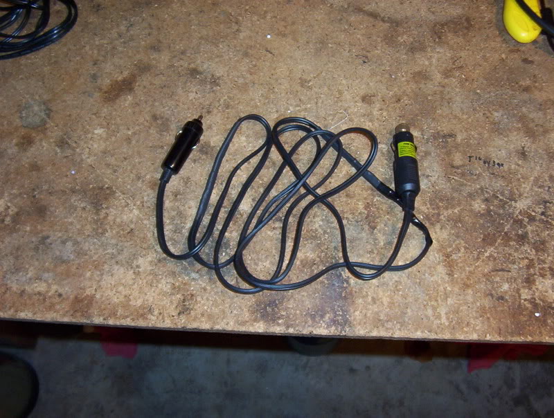

And bonus, I made a plug in jumper that works great. That way if someone leaves thier key on and the battery gets low, all I have to do is plug in and wait 3-5 minutes, and it will fire up the dead bike. Already tested in the garage.

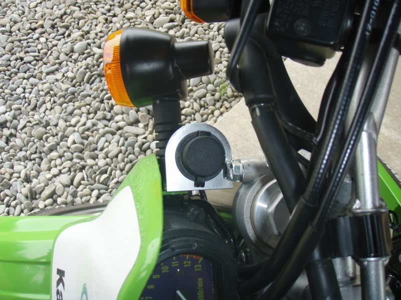

hmm...i wonder if this only applies to the type of usb connector you purchased...the tusk socket outlet (also fused) does not seem to affect my battery...it's directly wired to my battery to work without having the key on....had it parked for 5 days without any battery drainage...

That's definitely something I'm going to need to be mindful of. I decided to not charge my iPad last night and just see how it started this morning. I noticed the USB port was slightly warm which obviously means power is running through it even when not used. I would think it was a lot considering it warmed the plastic housing.
Anyone know if I can safely check the voltage of the USB port? If so, what would I be looking for as fas as a safe low voltage drain.
I'm going to charge the iPad tonight with the bike off and see how it does. I might call the manufacturer tomorrow to ask about the outlet heating up too.
