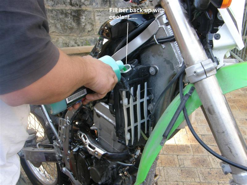

The hose that is attached to the carb that has coolant in it, is there a way to take that off without losing all the coolant?
Ok - I can see from one of WestOzKlx's posts that it's the de-ice system - and that it seems that I'll have to drain the coolant to take it off... What a complete pain in the ***.

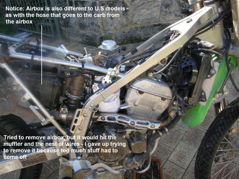

Right.... So I thought, how the hell am I going to get rid of all that oil?? So I took the breather box thingy that connects to the carb off and then thought maybe I can get the airbox off...
Well the airbox wont come off unless I take the muffler off or take the rear plastics off - which have got the nest of wires conveniently attached to it.... So to hell with that, but with the black flexible breather box thingy off I could get good access to the airbox and have got it spotlessly clean now..... So now all I need to do is start putting it back together....

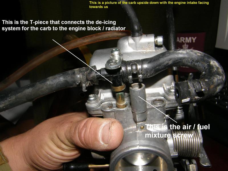

Ok So I'm going to put that carb on first.... BUT I'd like to remove all this de-ice CRAP - So how do you remove the T-piece that is connected to the actual carb or should I just remove the cables that are attached to it and plug it somehow?

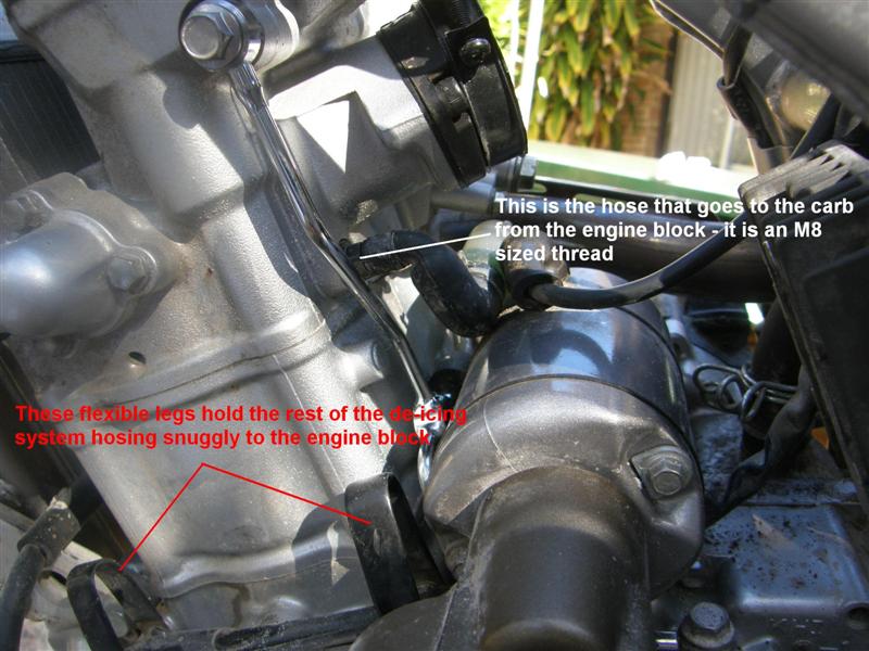

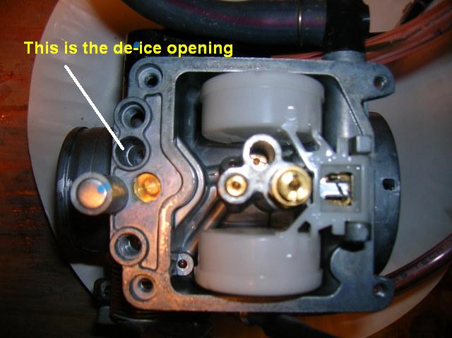

So anyway, that de-ice thing that plugs into the carb - is really easy to take off, you just undo a small dodgy looking screw and give it a little pull and it slides right out.
Is the de-ice opening blocked off by the float bowl on the U.S bikes? or is it simply left open?
I can't see why it can't be left open...

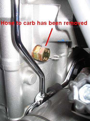

As for the hose that goes from the carb to the engine do the U.S bikes still have a hose that goes there, but it just doesn't go through the carb or is it simply blocked off like in this picture from WestOzKlx?
Or is the hole in the engine block not even there?

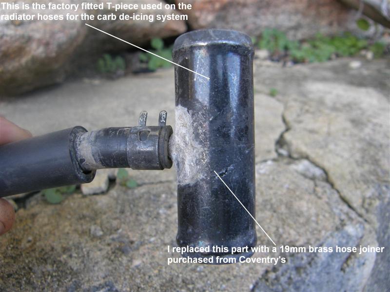

Thanks to WestOzKlx for his AWESOME write up on removing the de-icing system - which really turned out to be the job which took up most of my time. DirtSurfer also gets a special nod for his 'mod day' write up. All of which made it much easier for me to pull the carb off and put it back on.
So all up, I removed the de-icing sytem for the carb. Just like in WestOzKlx's write up on it, I needed a bolt and a nut - I used an M8 x 16mm bolt as I couldn't get a M8 x 10, which is why the nut is needed.
I also purchased a 19mm brass hose joiner from Coventry's and 4 hose clamps (14mm - 27mm).
