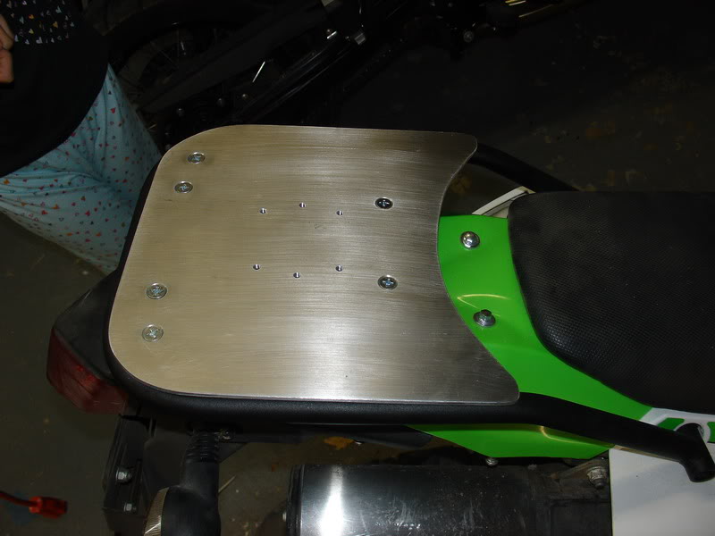

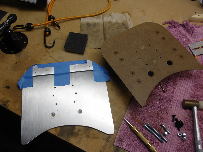

Ok. Drilled, Sunk, and Tapped as needed.
HardBoard to Aluminum transition is completed.
Match drilling beats measuring every time ;P

Bottom plated is threaded plus jam nuts

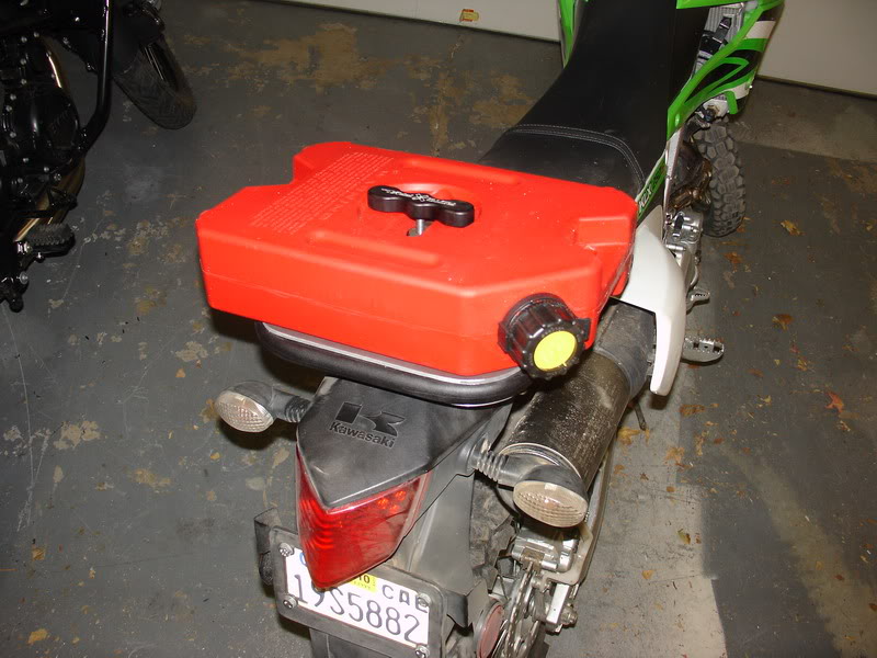

Add the Rotopax mount
And an extra gallon of fuel.
I like the +40 miles, maybe more if I am not trying to thrash an old rear tire

Nice work on the aluminum plate. I have the same Nomadic rack and just bought a 1 gal rotopax off ebay without the mount. My present thought is to use velcro / nylon strap to cinch the rotopax to the rack, then put a tail bag over it followed by a bungee cargo net if necessary. Did you ever try that approach before fabbing the plate to mount the roto base?
Also, how does the rotopax seal? Any leakage?

Straps would probably work. You may want a "bump" to keep the ropax located on the plate (just my opinion) then the straps would hold it down, while the Bump (1") keeps it located. Then start stacking away.
I have put many miles on my ropax and it does not leak.
Seal is rubber gasket and the cap has the serrated loop that requires a mechanical "unlock" (think child proof stuff") so that the cap does not vibrate loose.
