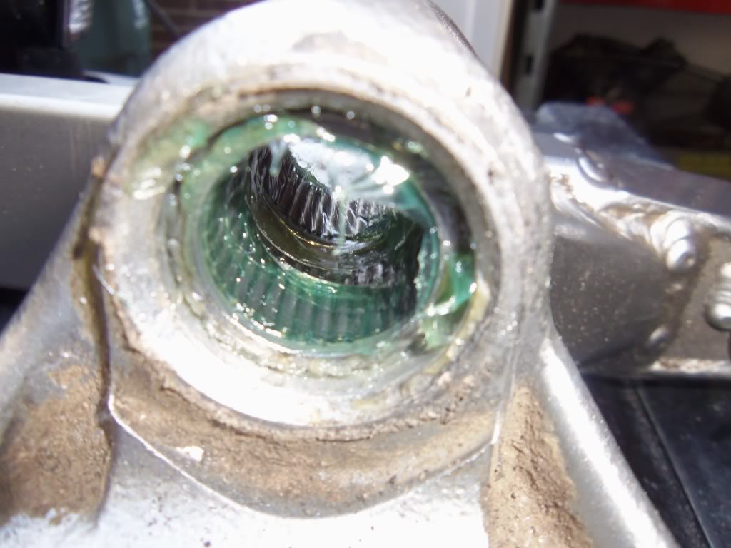

Thank you for taking the time to write this up, I just checked my 07 for the first time and found they were also dry, and some water got through one of the swingarm bearing seals.
Dry as a bone
Loaded up with good grease
Here's the one that had some rust, not too bad once I cleaned it up and re-greased, the seals looked ok too
Loaded up the rocker arm bearings too
Used this grease
All buttoned up, don't mind my cheapo stand

PSUDude...looks like you were able to save that one bearing. Good catch!

Yeah I'm glad I got a chance to dig into them. If I would have waited much longer that bearing would have been toast for sure! I have bought a spare bearing and will keep it in my garage if that one decides to take a crap on me this season.

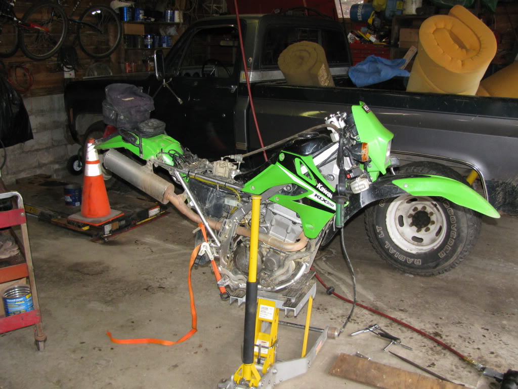

craftsman professional jack is awesome.

Someday I would love to buy a real; dedicated moto-jack. Haven't seen one that would work on twin-tube-type dirt bikes and also work on sport bikes. I've been using jack stands forever, though, so I probably wouldn't know how to act even if I found one. Tough to beat a ratchet strap through the triple, up to the rafters, for working on the front end. I've also been known to use a regular floor jack with a wooden plank (w hole cutout for the drain plug) strapped as a jack-pad. Works amazingly well.

That. Looks like an accident waiting to happen.... lol..... that 100$ craftsman jack is the best thing i ever bought for the bikes. i use it constantly.
