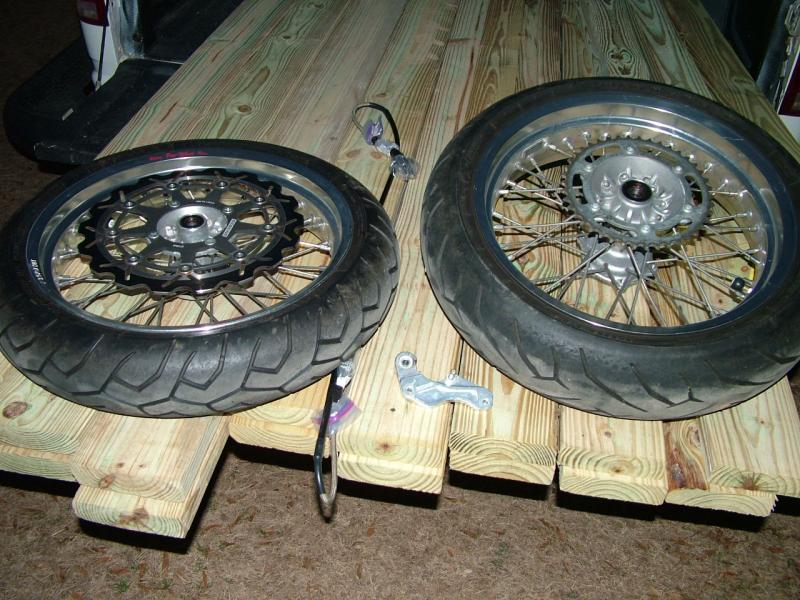

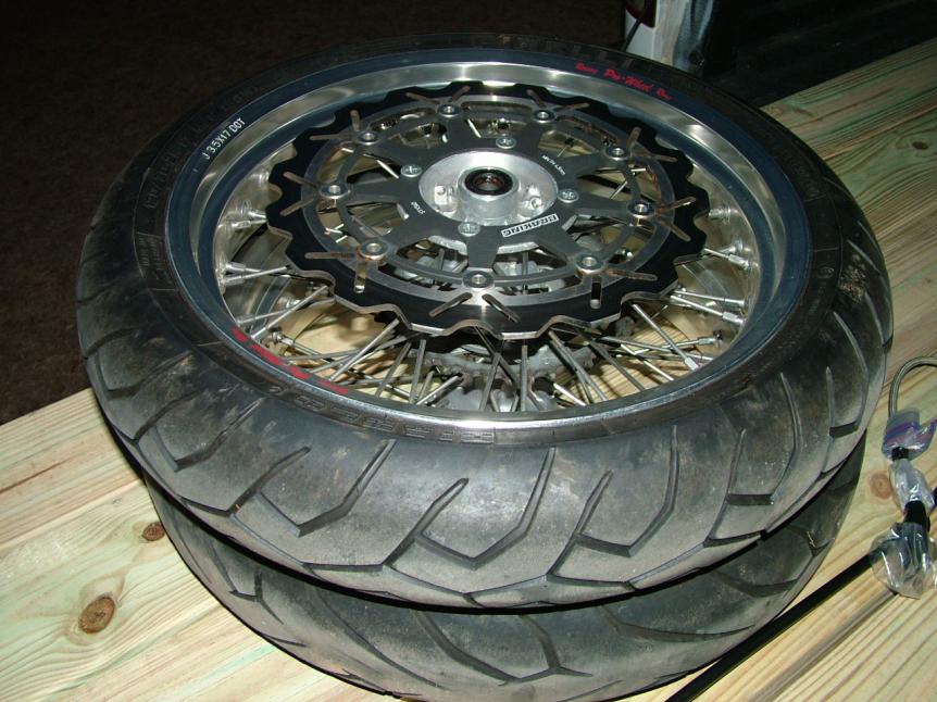

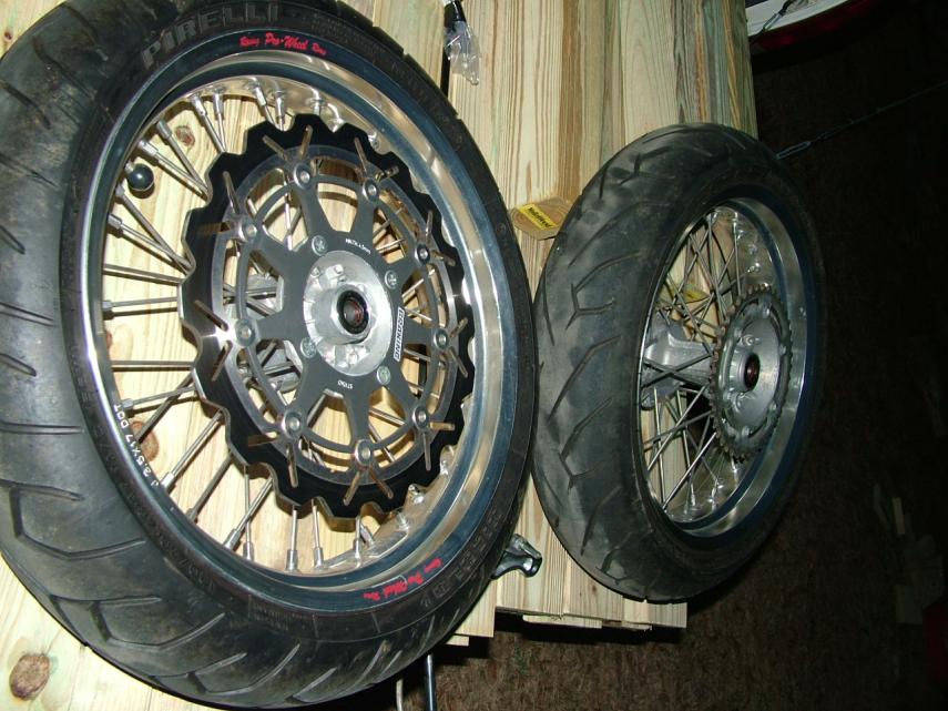

Hey what rotor is that on front wheel,and where did you get it? Was is direct fit or did you have to work it? I have not been able to find a larger front rotor for the front with out having to have it machined.

Hey Sideways1, EBC P/N: SM6330. That's for the 320mm oversize rotor kit for '06-'07 KLX250S. Look right above the highlighted line towards the bottom of the pic below. This was taken from the 2010 EBC catalog. No machining required, just a longer brake line.

It's A braking rotor not a EBC ,I got it from Parts unlimited or Tucker . It might be from a kdx 300 I think I found it on the older posts on this forum
