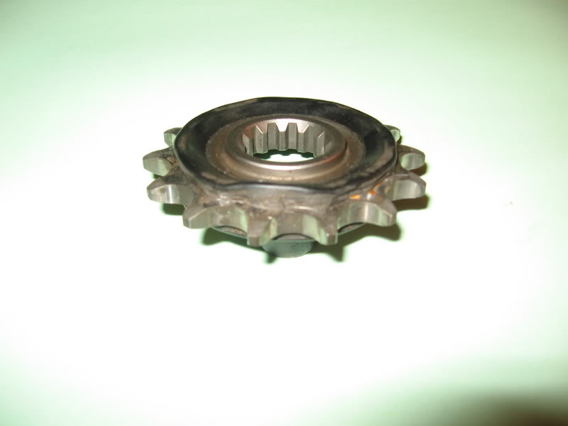

Since I just got a sunstat sproket & have never seen the stock one, can some one post a pic of the stock one so we can see what to look for?
I think mine has a spacer on one side of it.

okay, here's my old sprocket, it only had about 1400km on it when i changed it. You can see the shoulder in the first pic and in the second you can see the distortion of the OEM rubber bushing (which does not come on the aftermarket sprockets, except maybe the XR650L). The sprocket was crammed with dirt in behind it and i believe that contributed to the rubber distorting and it may have even been rubbing against the crank cover...soI personallythink swapping the front sprocket was beneficial in more ways than one, noise or no noise.
actually, you can see the shoulder much better in the second pic[:-]
