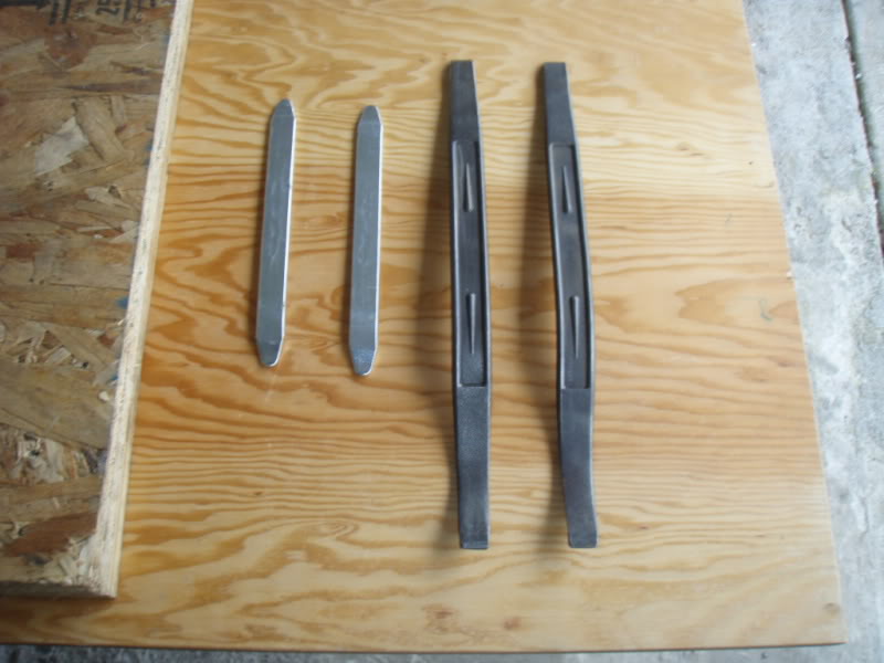

606 will be awesome Old Man! There are a few videos on the web that show exactly how to change a tire, but you first have to get some good spoons. This is what I have,

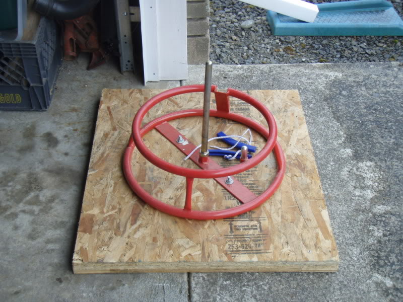

I also picked up one of these, and it really helps to keep the wheel from spinning and moving around.

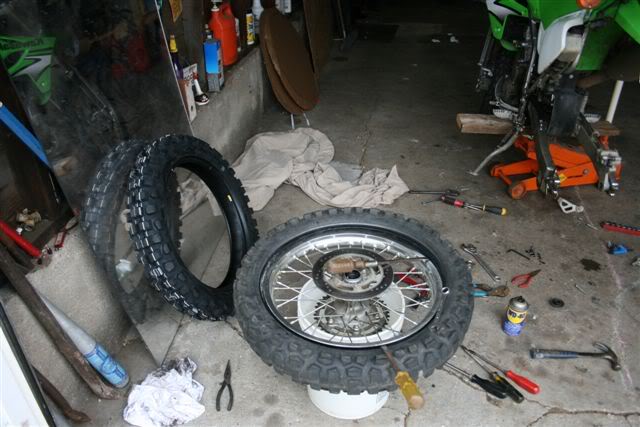

5gal bucket and some big sharp screwdrivers, all you need
I had some irons ordered when that pic was taken, just hadn't arrived yet. Deej's ring-a-ding thing looks like it would make the job easier too.
