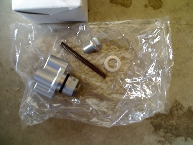

I'll try to clearify this better. The cam chain adjuster is located on the right side, on the back side of the engine clyinder jug. It is not in any way located inside the engine. It is a little part that has 3x bolts all together. 2x small bolts on either side of the center that hold it in, and 1x larger center bolt that holds the tensioner spring in (which also applies pressure to the rachet). All 3x bolts are within 1inch of each other in a near almost horizontial straight line.
This is what the cam chain tensioner looks like when pulled from the engine.
There are different steps to adjusting it. It is a self adjusting tensioner, but if the cam chain is slacking. The adjuster sometimes can't make up for it.
Method 1:
1. Locate the cam chain tensioner
2. Remove the center bolt and tensioner spring inside
3. Take a long, skinny, strong, object and stick it inside the hole
3. Apply enough pressure forward until you hear it click once (2x clicks will take more effort).
4. After the click, re-install tensioner spring and center bolt
Method 2:
2. Using a rachet, loosen the farthest inside bolt of the tensioner. You don't have to remove it completely.
3. Using the same rachet, start to loosen the farthest outside bolt of the tensioner. On this bolt, do it slowly as you are trying to hear the tensioner rachet click once. The tensioner should also try to come out because the spring is still applying pressure.
4. Once the click is heard, re-tighten the farthest outside and farthest inside bolt.

Got it Learjet, just went and looked at my bike and now see the tensioner itself and the three bolts, was just seeing the 2 but another futher that is hidden behind the tensioner. I think I will have to try this as I am hearing noises that were not coming from that engine before but no loss of power or no problem starting at all, just noise at 5k rpm and on acceletation and deceleration when you can hear with the Two Brothers plus a helmet on kind of skews the noise to some extent. Thanks again, I will let you know what happens.

Well Neil I think it worked. I heard what I thought was a clik or the sping poped out some or something?? I used Method 2. It rained all afternoon but just got to take it for a very short warm up and am not hearing anything now. I will have to wait until tomorrow to see if we get some sunshine here so I can really get it hot and see what happens then. That was a piece of cake, wish everything in life were that easy!

Well everyone, that little trick was about the easiest thing I have ever done and now the bike sounds like new again, no noises at all, one click was all it took!
