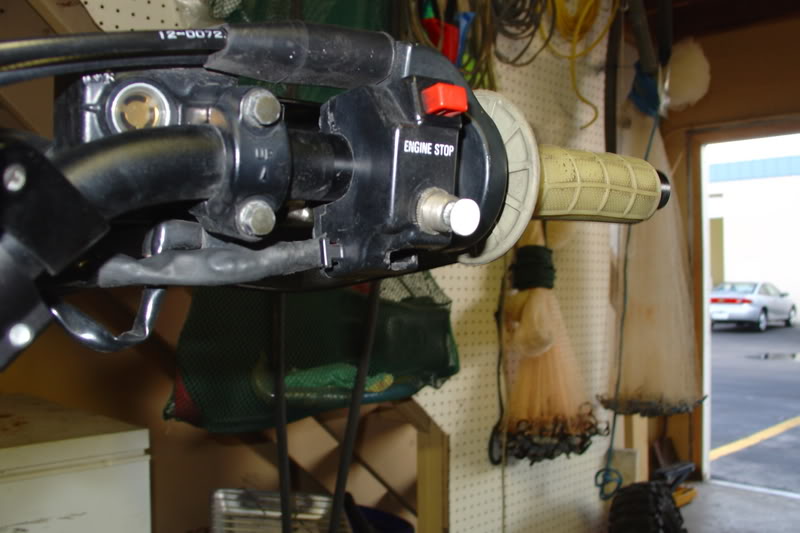

Old Nov 25, 2007 | 02:47 AM
Default RE: Stranded in the woods!!
I'm suprised this isn't posted more often. Here's a pic of my mod starter switch. Kickstarter rules thou
