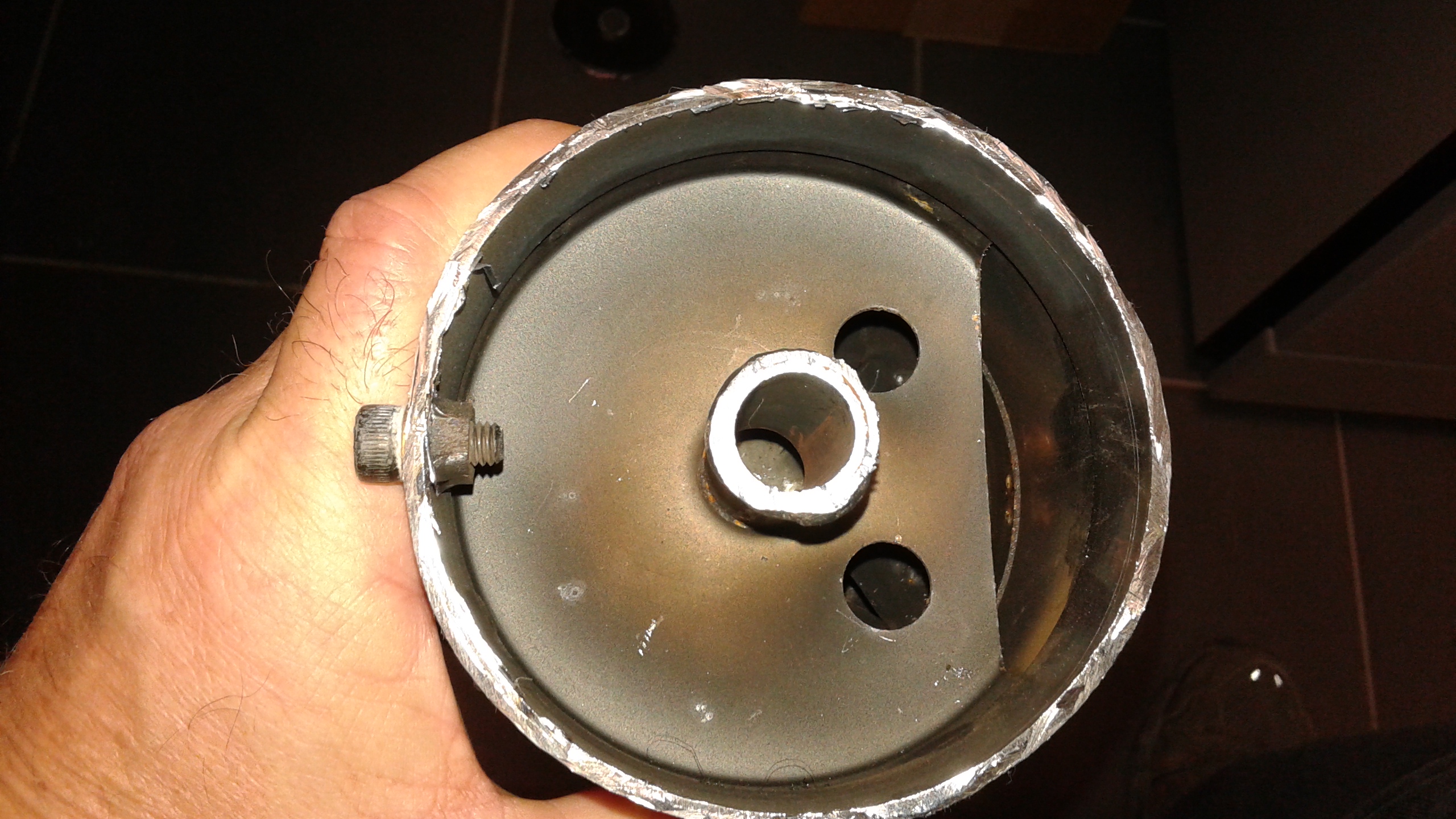

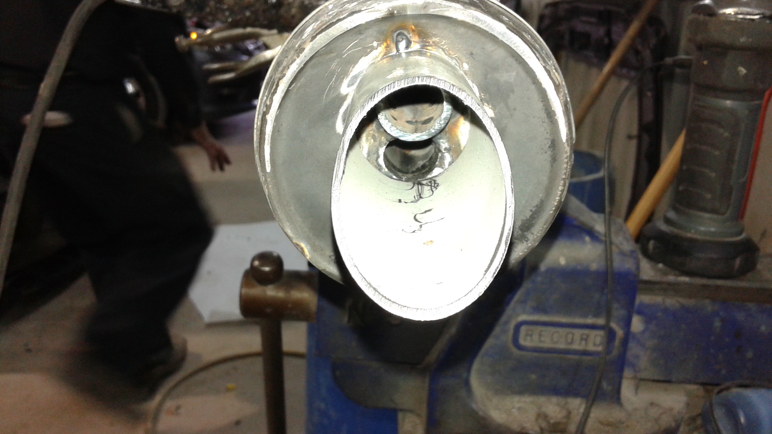

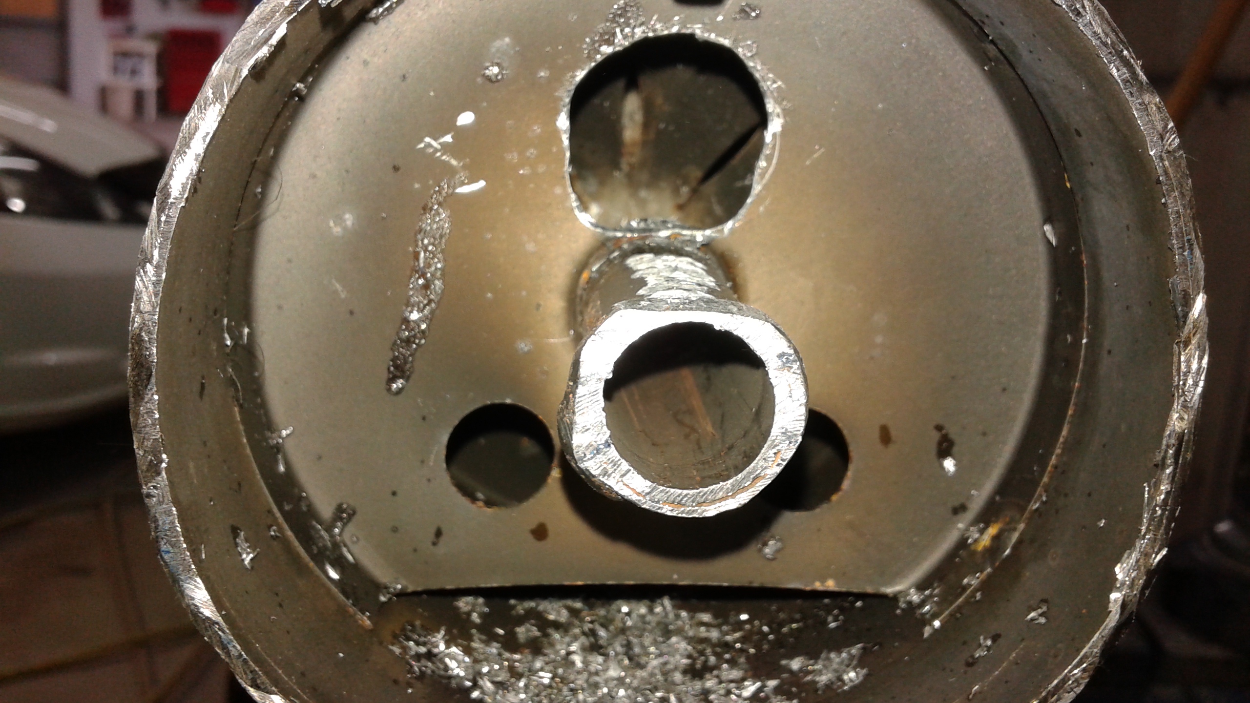

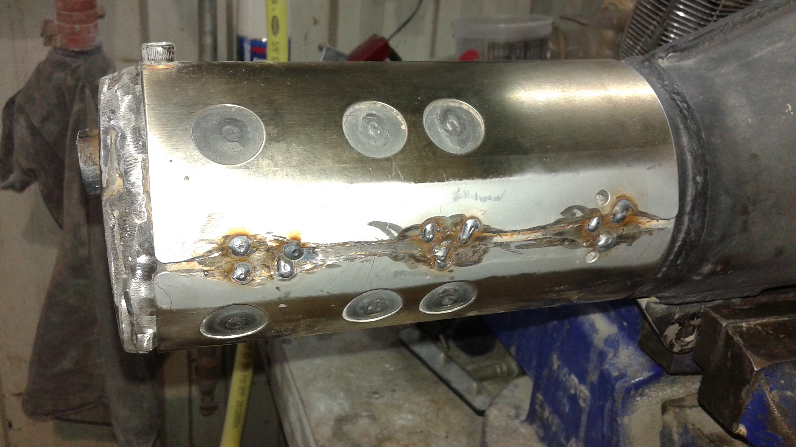

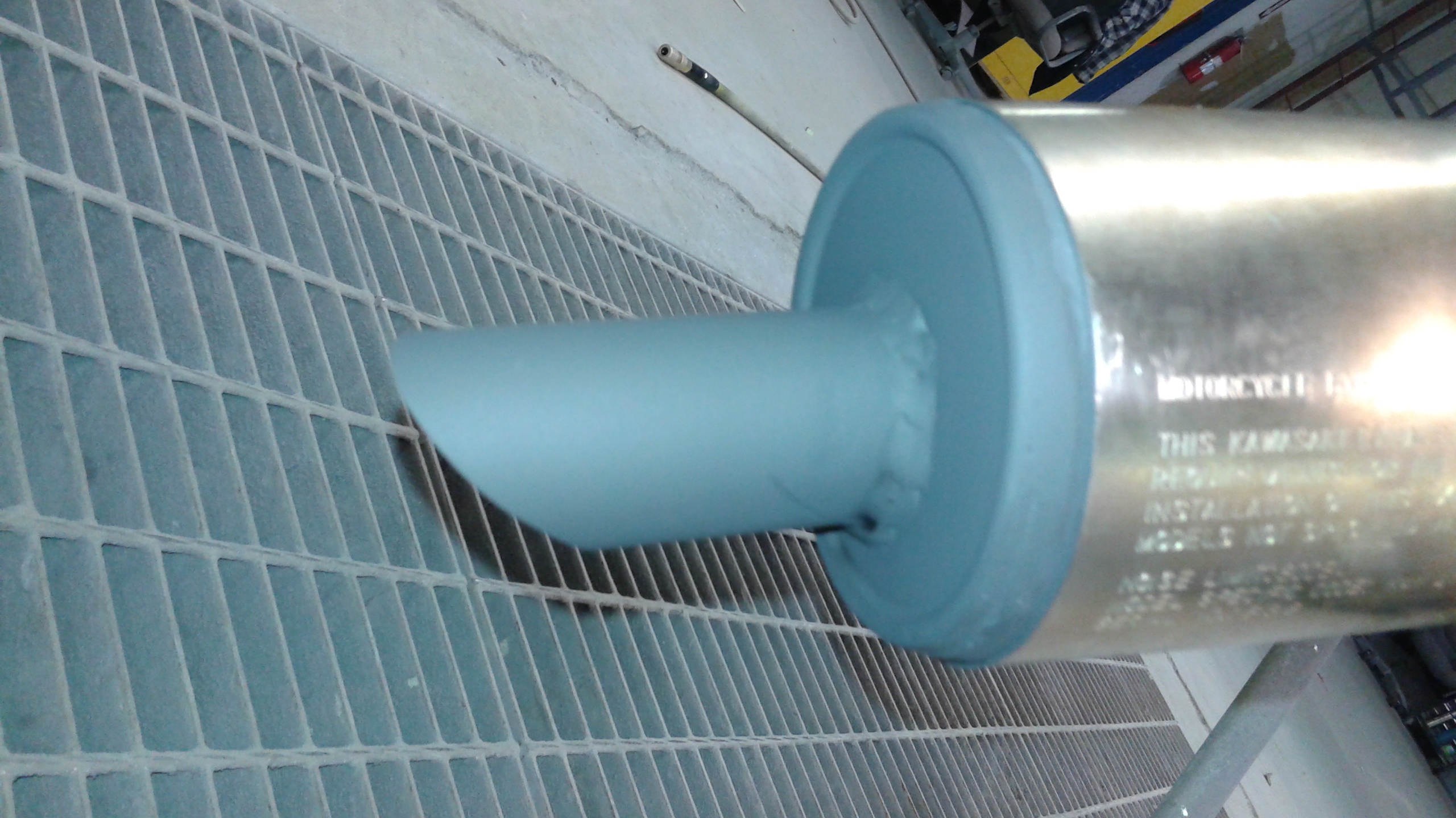

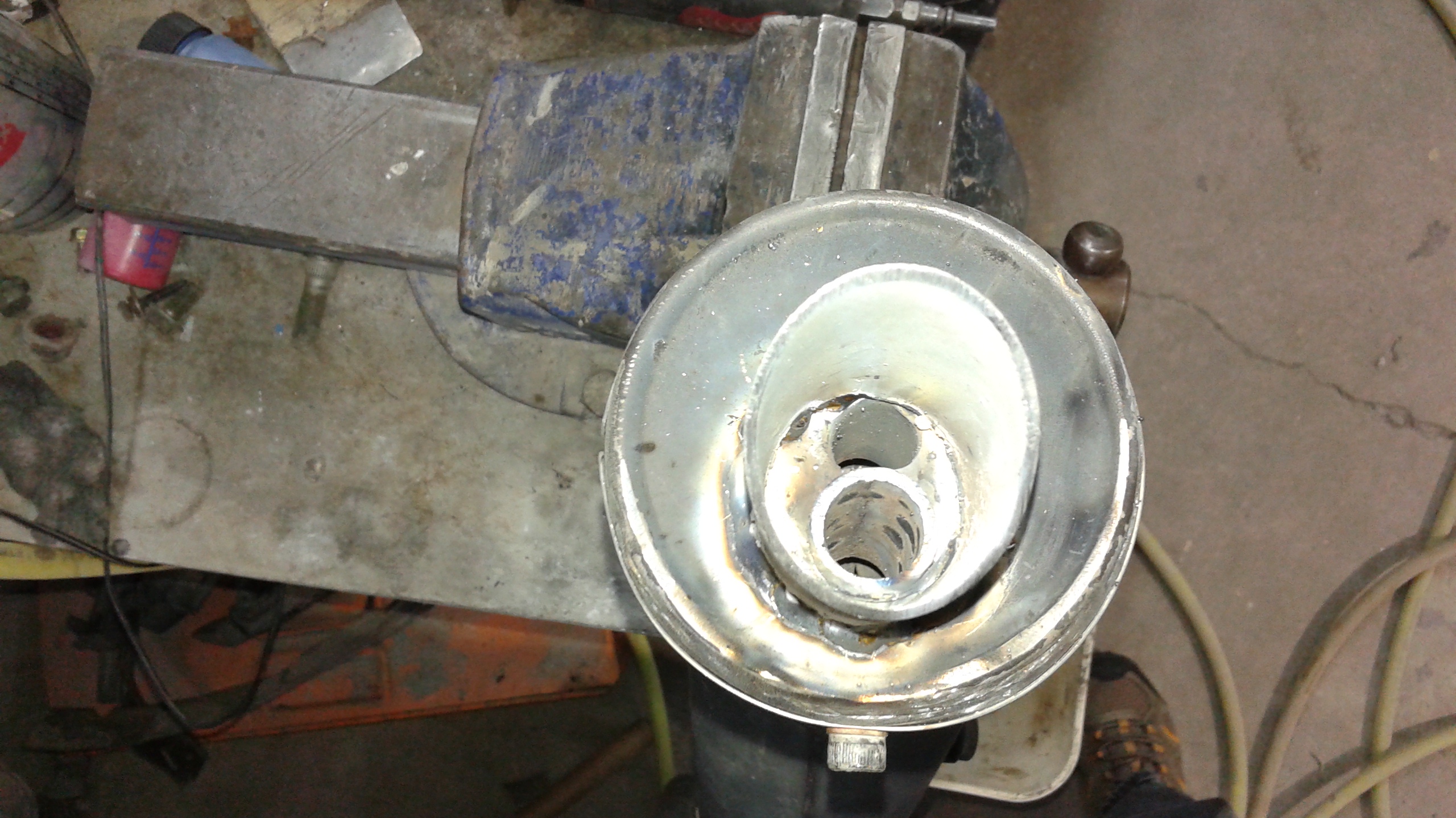

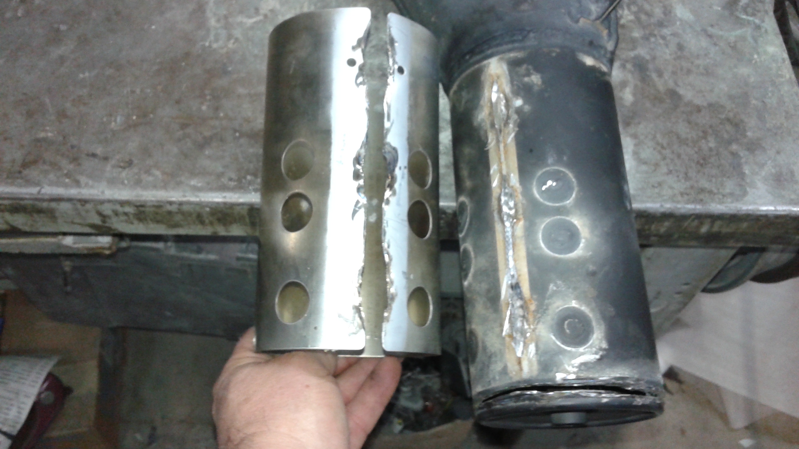

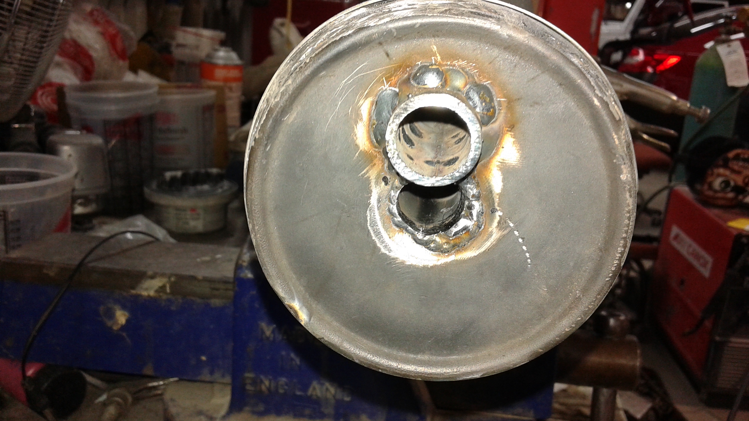

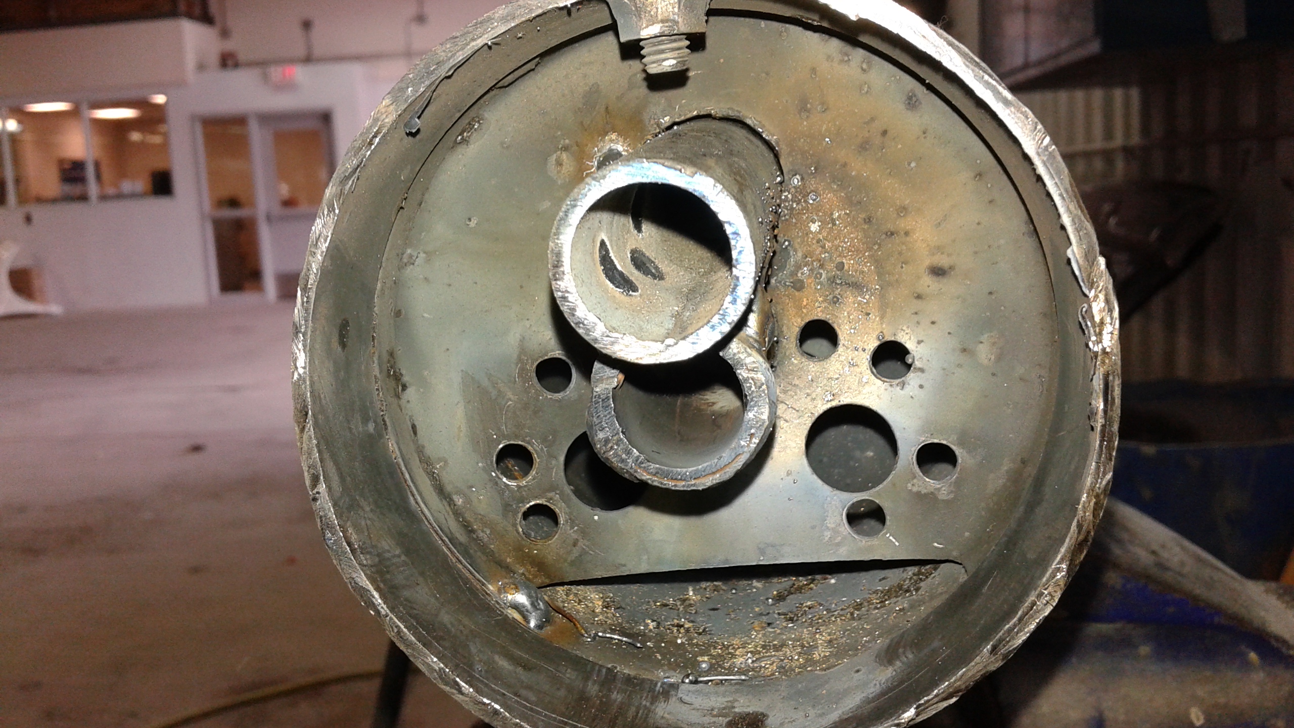

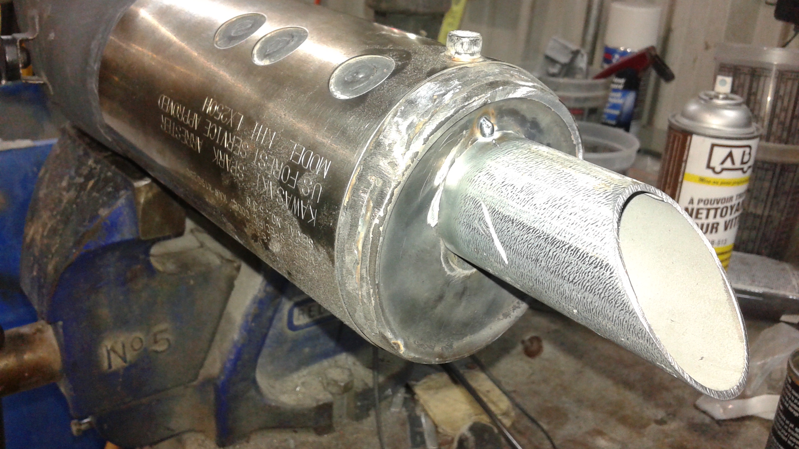

OK, so I have completed the surgery and I believe I have accomplished my goal of letting my 351 breath better while maintaining a stock appearance and only slightly changing the exhaust note while still not drawing any unwanted attention. What I have done is cut the end cap off, drilled out the first baffle above the existing tip, added a second and slightly larger pipe and welded them together. I drilled more holes in the last baffle only and re-welded the end cap. To hide the now 2 exits I welded a 1 1/4" tip on to the end cap. As you may notice in the photos, the second baffle has slots cut in it. I left this intact as I didn't want to change things too much. Seat of the pants tells me it worked well. Snappier acceleration and just slightly throatier sound. I think my jetting was a little rich before mod as Bill jetted it for snorkle removed and slip on installed.
I've seen it done on another site where they used an 1 1/8 inch holes saw and then removed the back baffle. Then put a 300 klx end cap on. Do you think this would work as well? Your thoughts?

Sure would work but I bet you would have to contend with lots of extra noise. My goal was to keep it quiet and just open up that pea-shooter to let it breathe a little better. Seems to have worked great but no Dyno to compare power. Butt Dyno says worked well.

Man that looks good! My 2 bros is pretty darn loud, gets annoying... Did you do the welding yourself?
