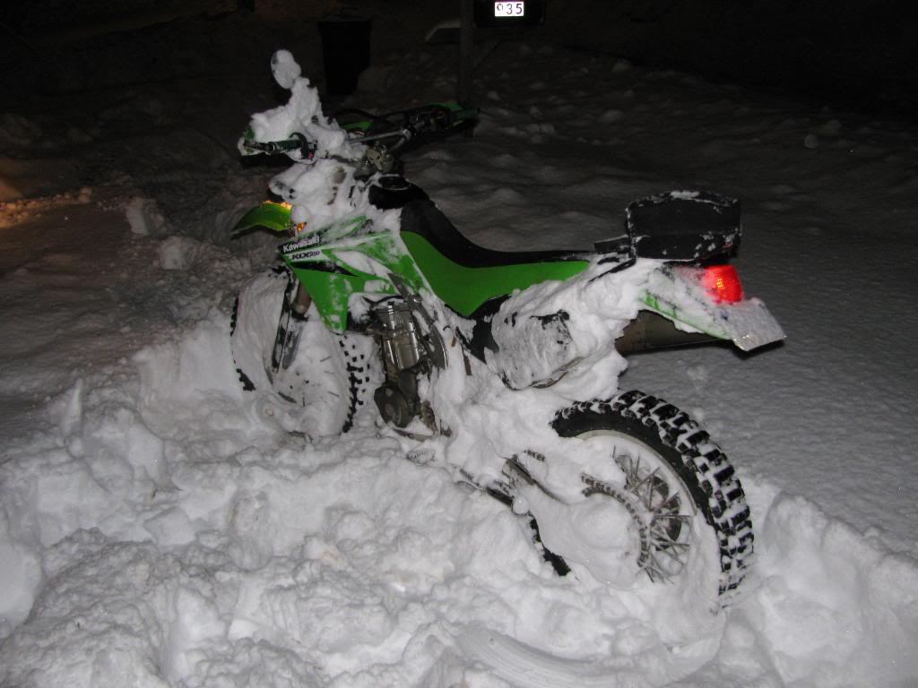

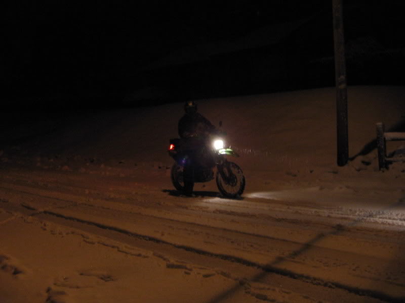

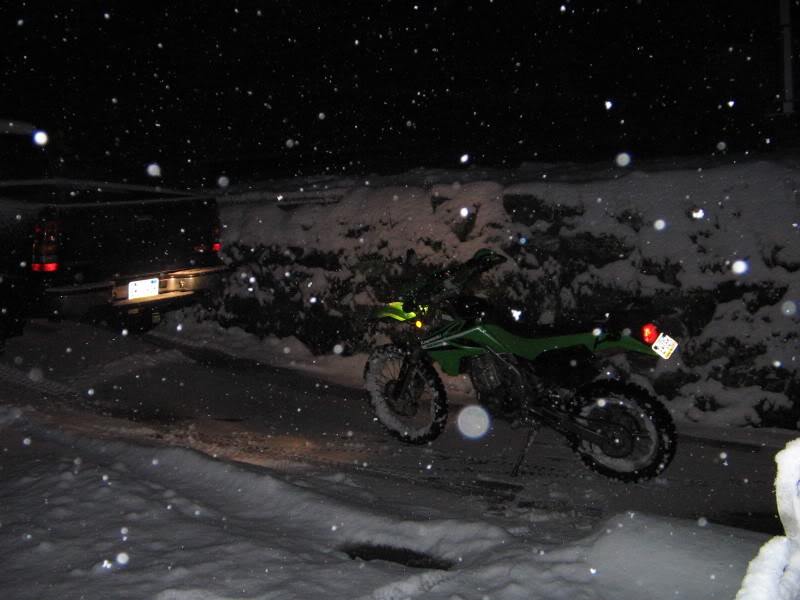

Mine starts all year round.... never had a cold weather problem starting it. The one year i started it and actually rode it to the closest gas station when it was 15 degrees out...
