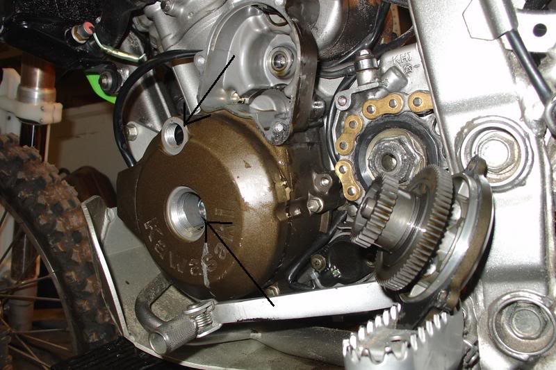

I don't have any pictures handy but, on the left side of your engine, where the flywheel cover is, there are two plugs with sloted heads. One is in the center of the cover and the other is toward the top of the cover. They have orings on the backside and I suppose that they don't have a torque spec because of that. But a large flat bladed screwdriver is all you need to snugg them up.
Old Oct 8, 2007 | 02:17 PM
vfrpilot's Avatar
Posts: 1,349
Default RE: Something to check on your bike
I just found (stole) this pic from fingermullet. it shows the locations of the two plugs.
