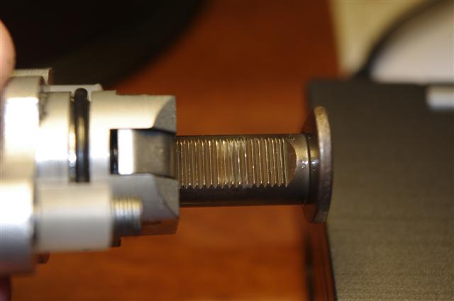

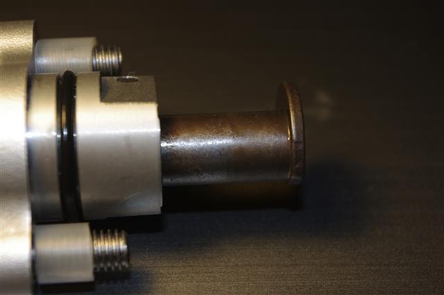

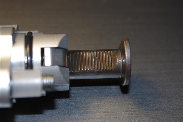

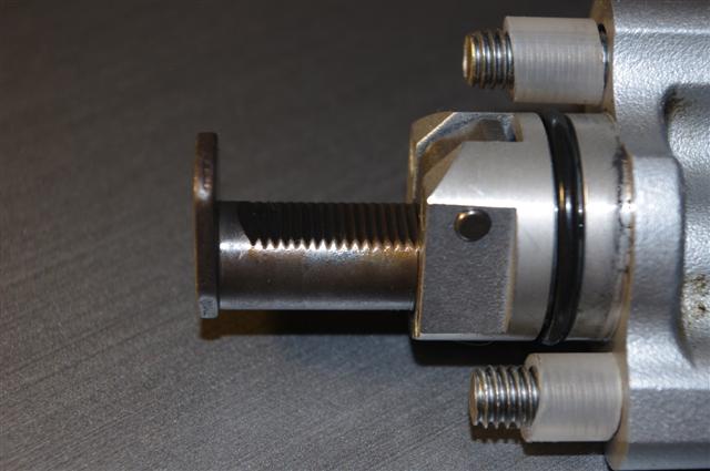

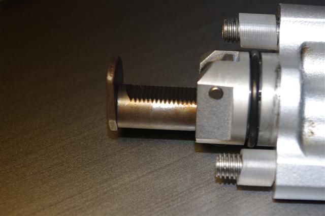

Another happy customer here. If anyone is in doubt if their tensioner is bad, they can easily remove it for inspection to determine if it's slipping in and out. The "design" only allows the tensioner to extend one tooth at a time. It should not be able to retract. A shiny spot on the shaft is a dead giveaway that it's slipping. There shouldn't be any wear spots on it. The attached photos kind of show it, but it's obvious when you are holding it in your hand. The Krieger manual adjuster should be the standard part on the bike IMO.
