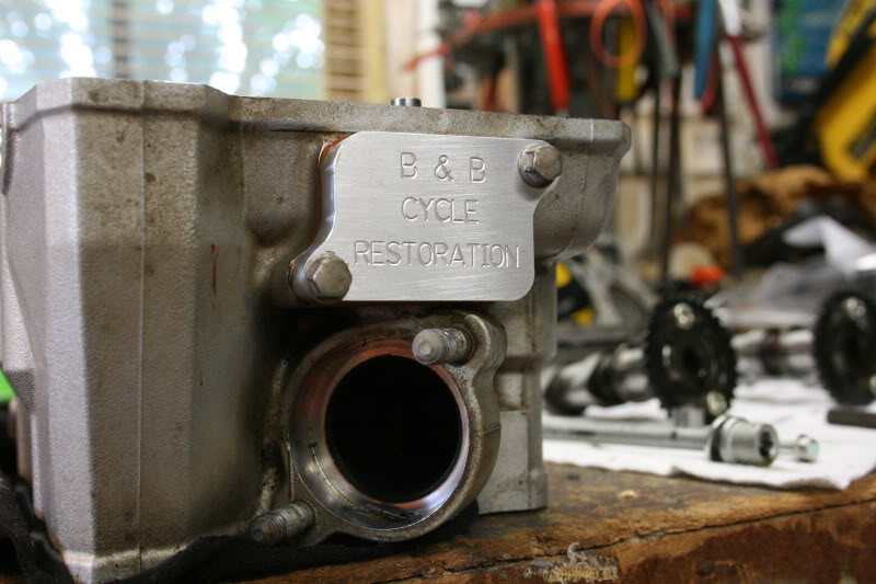

You can buy one like this from Bill Blue http://bandbcyclerestorations.com/
Or you can just leave the stock cover on that spot and cap it with a vacuum plug after you remove all the smog crap. No performance gain from removing the smog stuff. Cleans up the engine.

I took the stock plate off and ran a 5/16" tap down the nipple. Then I ran a screw in with some high temp silicone. You just have to plug it off. The Bill Blue plate is a good way to go. Really cleans it up.

the blockoff plate is less than most of us spend on dinner of beers on any given friday.

also noticed lower exhaust temp and reduction in decel popping after installing blockoff plate.
