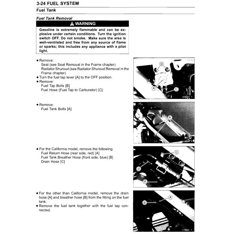

Edit: I was reading the service manual and from what I read, I'm thinking the RED port should be capped and the BLUE port vented with a hose. For non-California models, the service manual only talks about the drain hose and breather hose. And for the California model, it says the RED is the fuel return hose. Here is the page I am referring to:

The only thing I did was remove the emissions stuff. Like I said in my original post, "I think my canister was just so fouled up that it was causing me problems". When I said my bike is running better, I just meant it seems to start and idle better now. Also the bike used to have pressure in the tank and I could hear it releasing pressure whenever I would stop. I've not had any tank pressure like that since removing the CA smog stuff. The tank breather line used to go into the separator so having it fully vented may have helped.To be clear, I've not noticed any performance gains as far as HP or torque. The service manual says that overfilling the gas tank can cause fuel to run into the canister and when that happens, it needs to be replaced ($80 part). I don't know what the previous owners have done so I figured since my bike hasn't been running top notch that I would try removing it (it wasn't hard).
Anyways, I took it out one day and tried capping the RED port and venting the BLUE port. It runs good like that and I no longer have gas dripping on the ground. After about twenty minutes of riding, I removed the cap from the RED hose for inspection and about 1/8-1/4 of a cup of fuel came out. This is way too much fuel to be losing within a twenty minute ride so I'm going to keep the RED port capped and vent the BLUE port.
I found this in the service manual, "Liquid fuel is caught by a vapor separator and returned to the fuel tank.". And the previous picture i posted said that RED is the "Fuel Return Hose". So that would lead me to believe that the RED port is an input for fuel to travel up and back into the tank. So I feel that capping the RED port and venting the BLUE port is the correct thing to do despite what this tutorial says.
