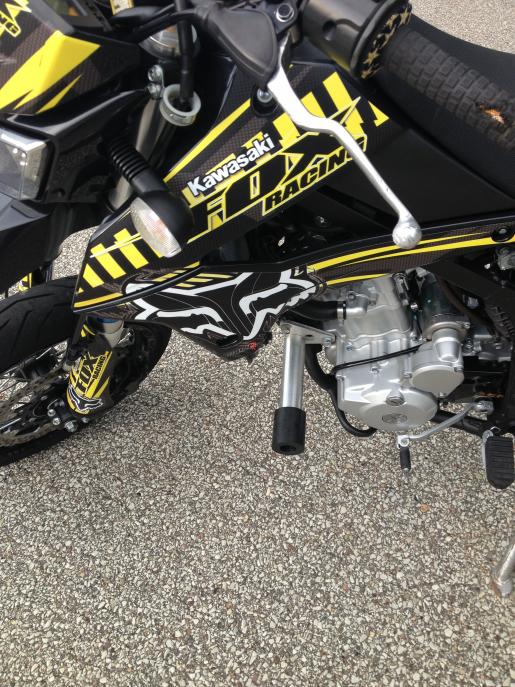

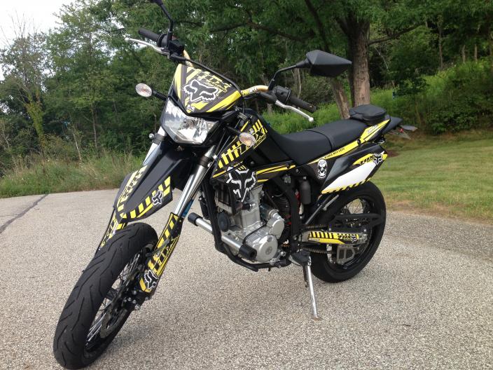

Thanks for the pics and info Joel! I made sliders back in august but have been so busy I forgot to post pics until now.
Attached Thumbnails Slippin' Sliders-klxmod4.jpg   Slippin' Sliders-klxmod3.jpg
Nice work on the sliders. They look good.
BTW, that's a pretty bad *** looking KLX, too.
Thanks Rooster!
Also I forgot to mention I actually changed the puck design a little bit since I took the pic. They are a little longer now and have a taper on the edge.
