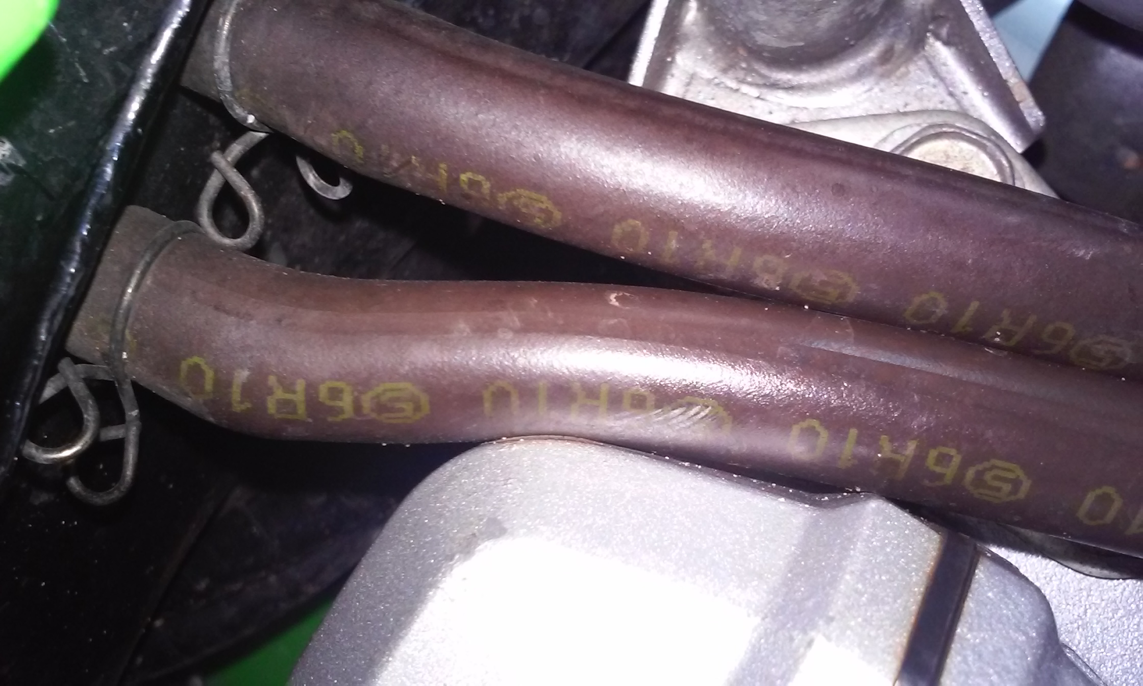

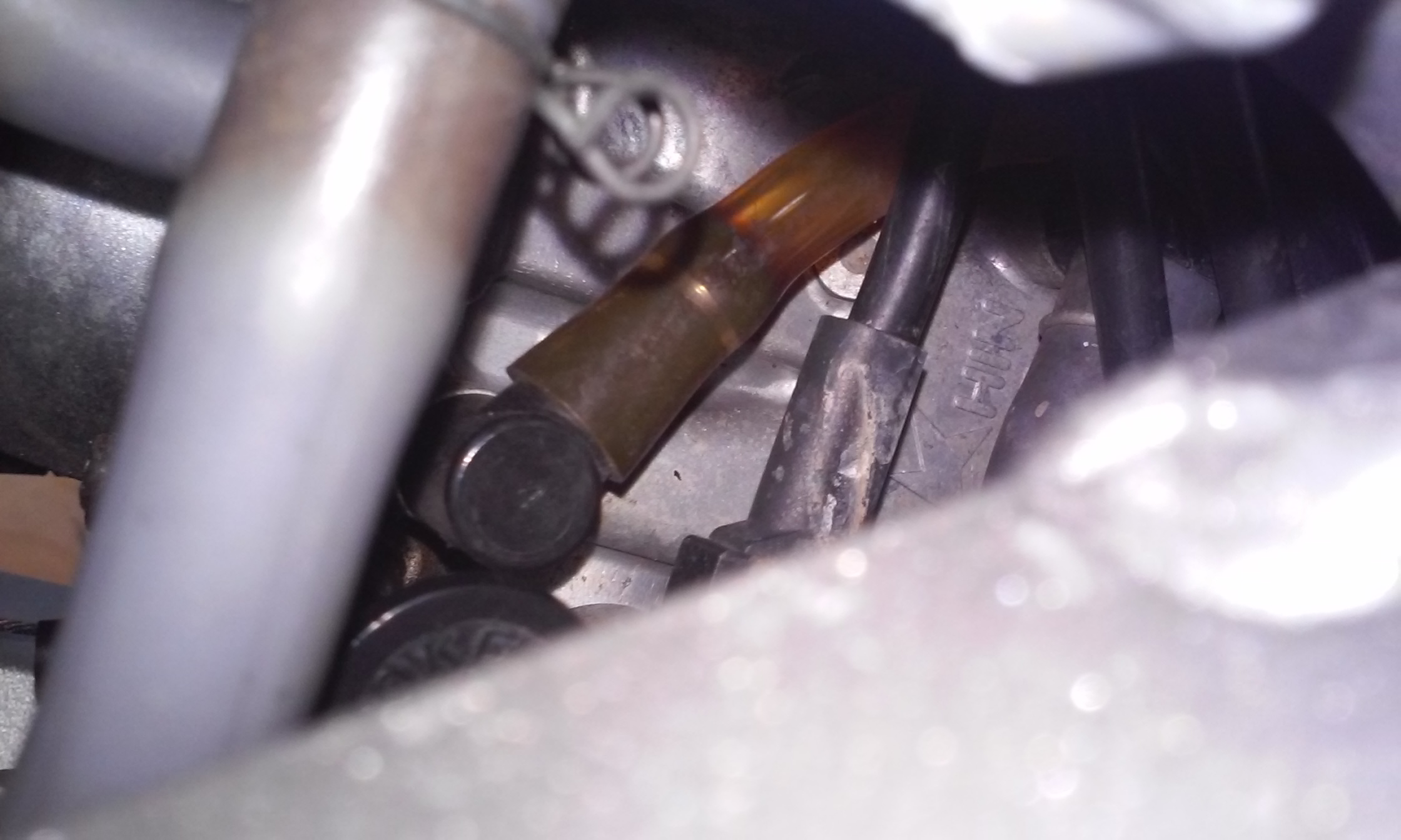

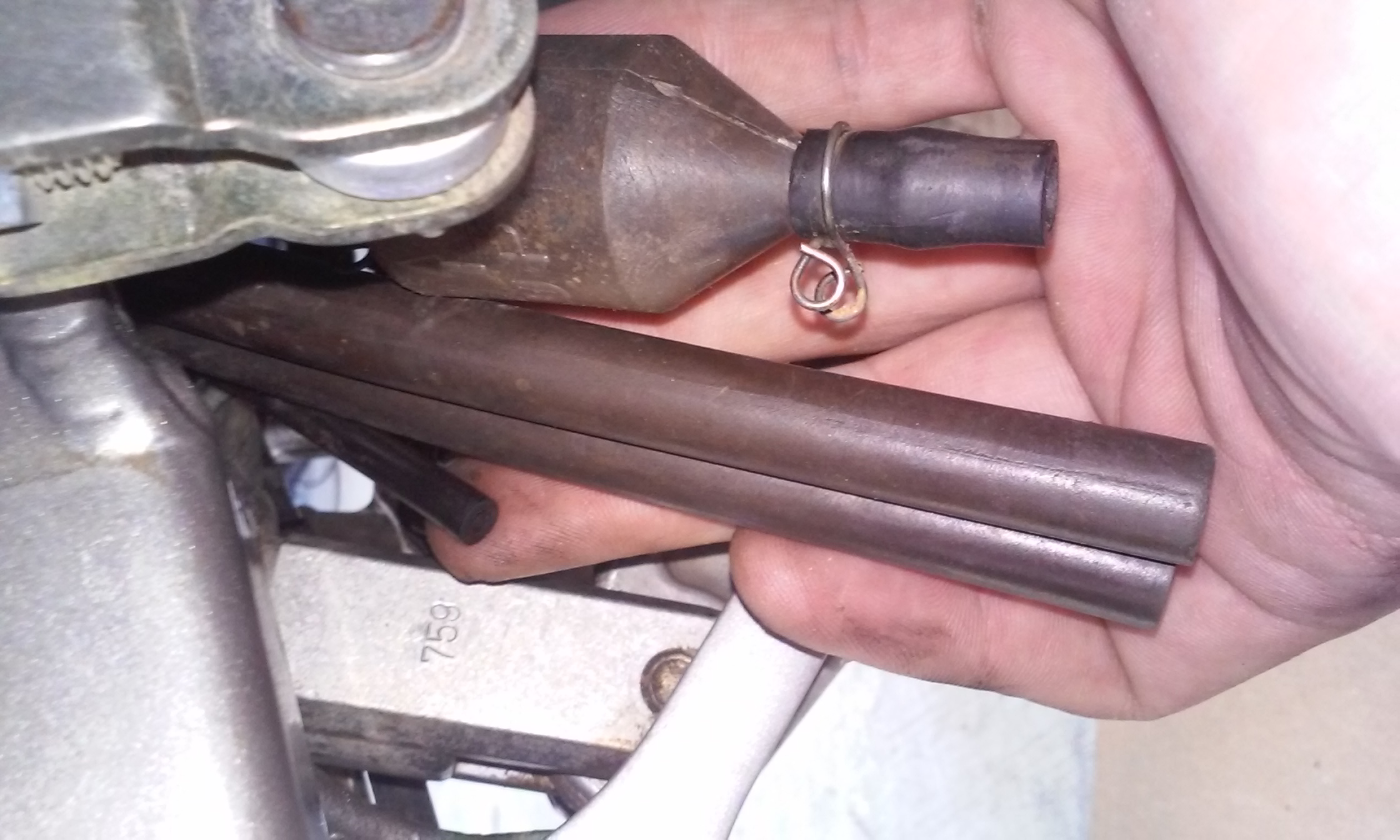

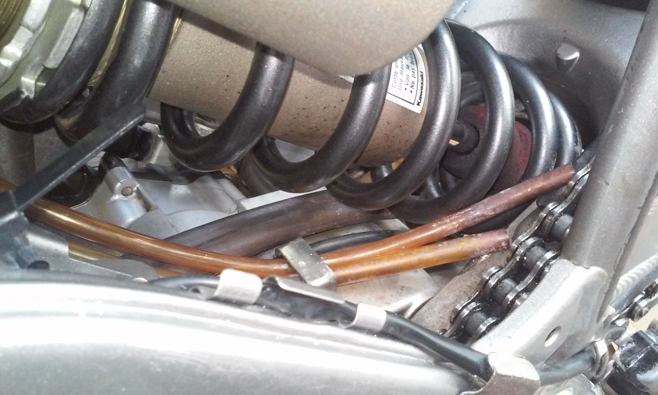

So i was washing my bike when i found three rubber hoses were loose. i inspected them and one of them had a dirty, clear cone looking plastic thing that said "UP" and it was attached to one of the hoses, at the end of the cone it had a clamp looking thing which makes me think it belongs attached to something or another hose. I took it out gave it a sniff and it smelled like gas. I checked and theyr'e apparently attached to the gas tank. Then i found a smaller rubber hose which im not sure where it leads to. after that i go to the other side of my bike and find two clear yellowish ones that are under a metal looking clip thats part of the fame. Im guessing these two clear ones belong here? Where do the other four go?are they supposed to be attached to something else? If anyone knows what they are or have any idea please let me know, keep in mind im a KLX noob and its my first bike, so i am still learning(:

The big two matching ones are your gas tank vents and the clear tubes are your carb vents (look into a T-Mod for those if you do water crossings) I forget what the UP one is for, but its normal also. It'll prevent you from spilling gas all over your extremely hot exhaust system in the event you tip your bike.

1st picture is the airbox drain and 2 gas tank vent lines. The bottle is supposed to be capped so it doesn't drip oil in front of the rear tire.
2nd picture is the gas tank vent lines again.
3rd picture is the gas tank vent lines and carb vent lines (the ones that get the T-mod).
4th picture looks like a carb vent line if that is the choke plunger I see.
They are all supposed to be like that(except the catch bottle)...bikes gotta breathe!
Actually capped so you can "drain off any oil/fluid from the bottle and dispose of properly" per EPA type thought process. Those drains in front of tires were open drains for years before I'm thinking the late 70s or early 80s. Before the bottle they stuck caps in a clear line. My 650 had the cap - it doesn't any more. Unless my engine blows all its oil out into the air box, there is no worry about oil on the tire. If that happens I'm sure I'll know before it gets to the tire.
If really concerned about it, reroute the line off to the side away from the tire. Some bikes have all the lines off to the side already.
