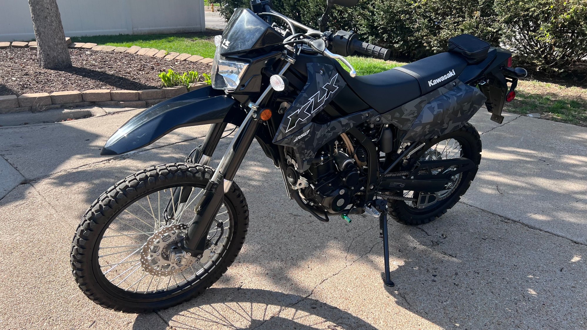

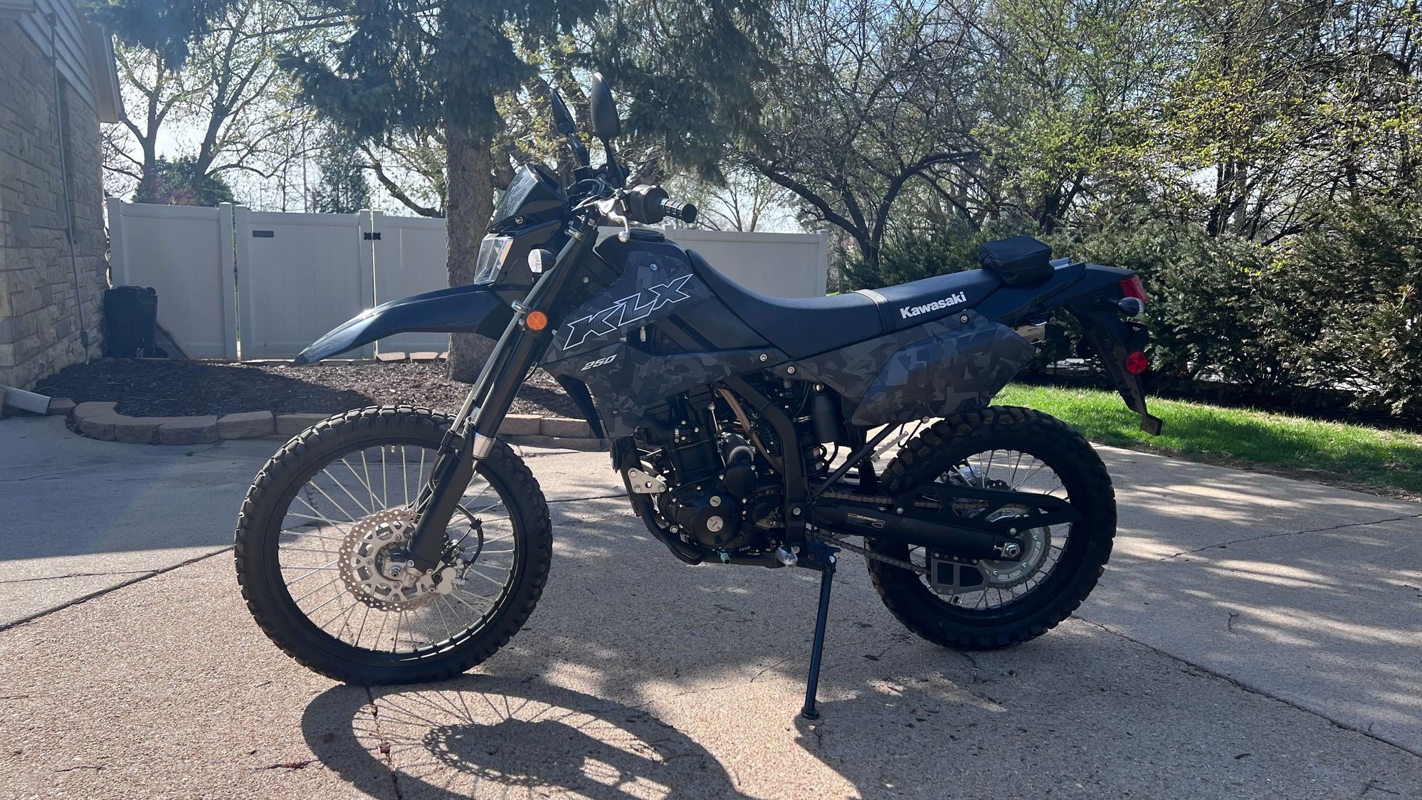

I went with the 2020! 497 miles and a flat front tire. It’s a clean bike as you might imagine. I need to spend more time on it, but after a few miles I think the front sprocket swap might be a near-term project.
I haven’t ridden a bike this size for a long time and hot damn it’s a good time. I’m excited for the summer 🤘
