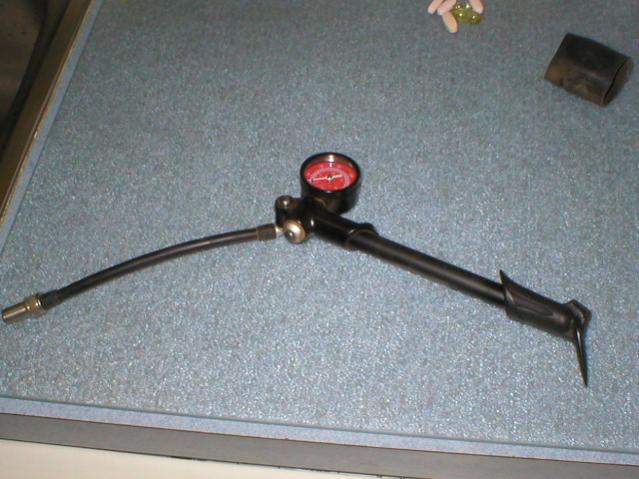

Yeah, I think there may some truth about nitrogen not losing its molecules as compared to plain air, but I think it's more applicable to tires or other items where you have a microscopic porosity on a larger level. The great thing about using air is that you can use an inexpensive bicycle shock pump...that's shock pump not bicycle tire pump...to check and maintain proper piggyback/bladder pressure in the shock. As nitrogen pressure drops, the shock becomes more akin to an old school emulsion shock.
