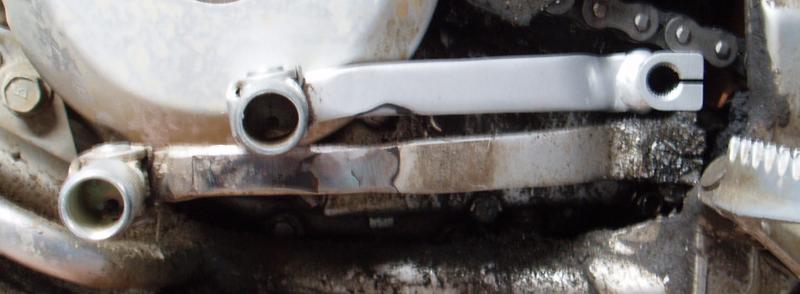

I think the Honda lever is the XR650L not the XR650r as EMS mentioned. ??
Here is the Honda lever I put on my KLX note the length difference. I will look to see which model Honda I ordered for.
Dan

Looks good Dan, thanks

Thanks, Dan. I see my next purchase...

Dan, you're correct. It's for a Honda XR650L not "R" model. I use that shifter too. It's been great. It's mild steel, and it survives crashes and tipovers quite well. I only have a size 10 foot, and I couldn't hardly even use the stock length with my riding boots. If I cocked the OEM shifter up high enough to clear my boot, it was pointing high enough that I could almost reach down shift it like a Hurst floor shifter.

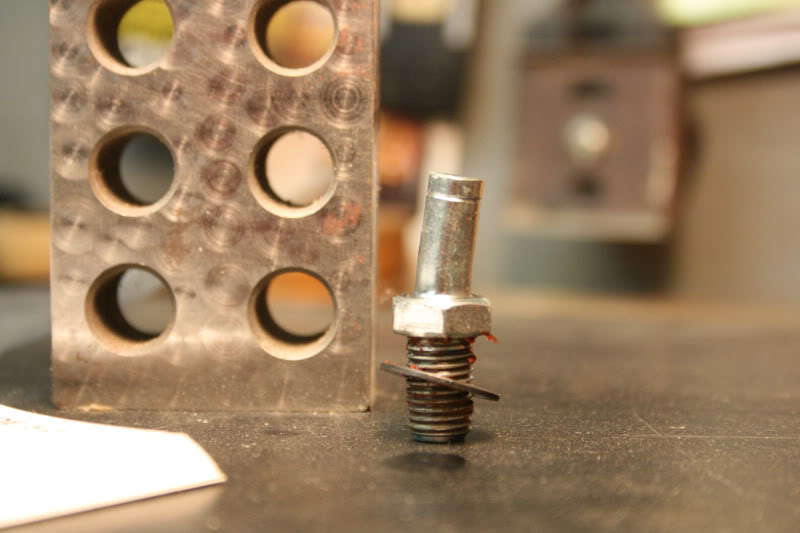

I should add that I think the MSR lever is beefier than the stocker, and that may have contributed to the bending of the internal pin that limits the shifter movement. In other words the stronger lever transfers more force to the internal pin in a crash. From the looks of the internals it was something that had happened over time, not just one hit.

It was already bent when this picture was taken, so this is a freebie crash.

IDIDR, here are a couple of pics of my extended shifter. It was cut just behind the tip to insert the extra length.
Attached Thumbnails shifter adjustment-shifter.jpg   shifter adjustment-extra-length.jpg

Thanks for the pics. Looks good - I may give that a try.
