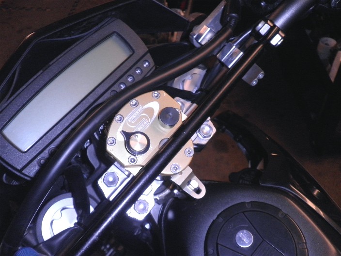

had a problem with the protaper s.e. bars after installing the scotts steering damper...the protaper crossbar sat way too low...didn't want to buy a new handlebar....this little crossbar is just too short (10.5") and solid to fit in any rod or pipe bender...solution?...took it to a metal fabricator for some custom bending by hand using hand tools...with just a printout using a computer of his plans as a guide...he did an awesome job....the protaper pads would no longer fit, so i just bought some black heater hose, cleaned it to a pure black, and covered the metal crossbar...looks quite awesome...

Just curious, with my scotts installation the stabilizer is turned 180 degrees opposite of the way yours is mounted. The sales person at scotts asked if I wanted the sweep arm mounted opposite the way I received it, now I see what he meant. Did you need to bend your ignition key, looks like you don't have to. I have the arm puller so I could perform the same install as yours...rebend my keys back to normal. The crossbar just clears the stabilizer, scotts sells a special crossbar just for the same reason you have done on your bike.

Thanks for the pics of your scotts stabilizer. Reinstalled mine the same way since the keys operation isn't hindered like in the forward position. Yeah the renthal crossbar does limit the adjustment **** but works perfectly in the range needed.
Were you required to clearance the top triple clamp for the bolt on post or did you go with the weld on post? Thanks

ordered the bolt-on kit specifically for the klx250sf from scotts...literally bolted on with no problems...
