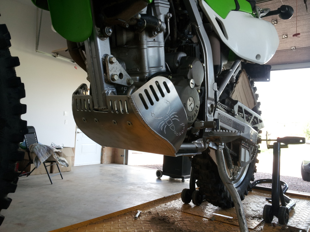

Installed them this weekend. Easy install, looking good, happy with the purchase. Hope I will never "use" them though.
Also installed Scorpio skid plate. Bit more fiddly, as I found out it was impossible to install it with foam strips sandwiched between the frame and the plate. Nevermind, the fit is tight, tested it thoroughly in dirt, no vibration noise (yet).

@ Sharan - I had the same trouble getting the skid plate on. I ended up threading on the back bolts loosely, then I threaded the front bolts after applying some leverage with a floor jack, and then I tightened it all down. BTW, I put the foam on the bike frame first.
So if you get some noise and take it off, try it again with the foam.
And I'm not saying it was easy, I got the knuckle scars to prove it, just that it can be done.

Oh, OK, the floor jack idea didn't occur to me. I was pushing everything together by hand and after couple of beers and dozens of profanities I decided to peel the foam off.
I could not engage the front rightmost bolt into the thread for the spacer was touching the frame. I filled ~1mm off the spacer where it touched and that was it.

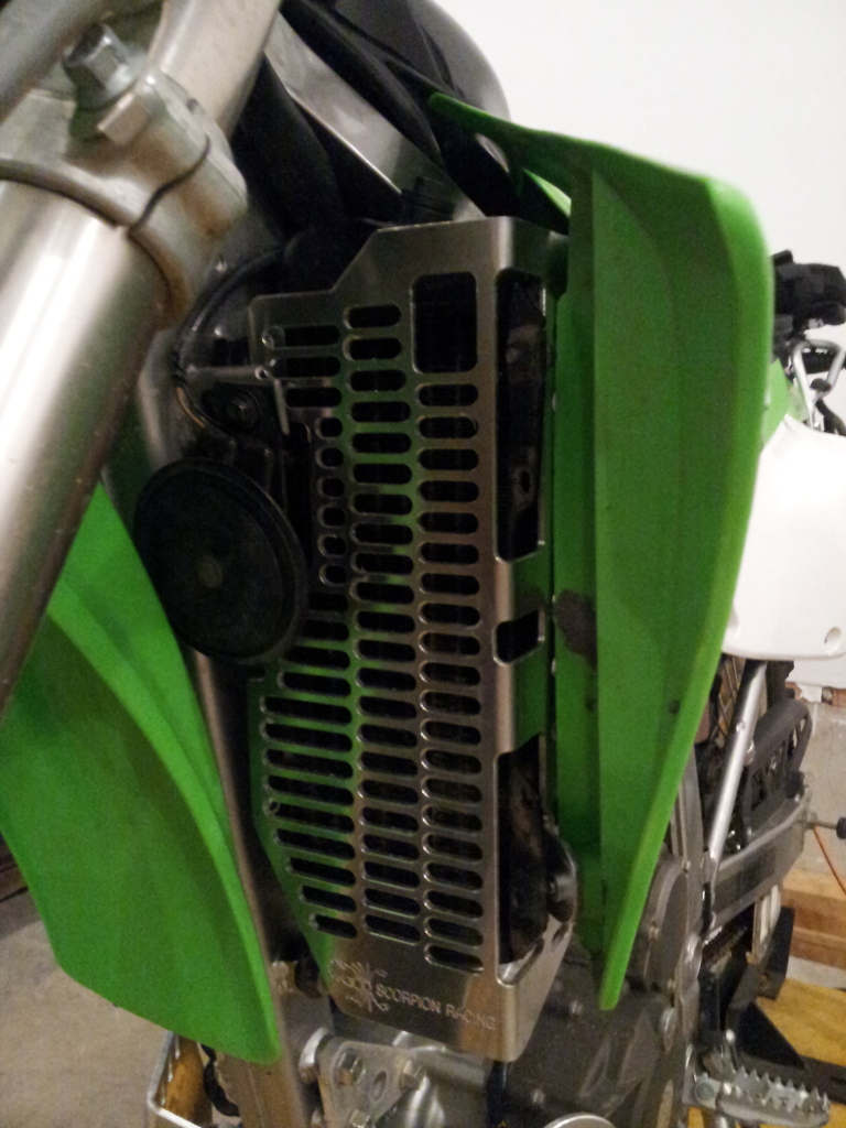

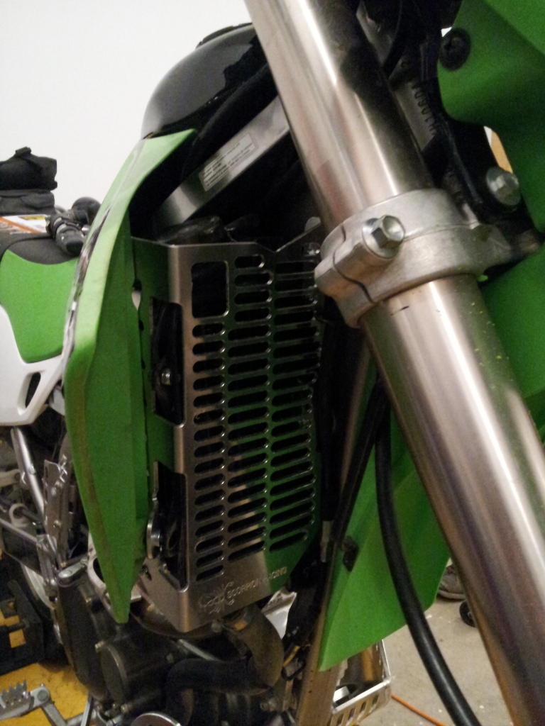

I had the same trouble with my skid plate... I assumed it was just me, cuz I always seem to have that sort trouble installing simple bolt-on parts for some reason. As stated, the floor jack, and putting the foam on the frame worked, but still required some maneuvering.
Rad guards went on well. I like them a lot. I can hear a vibration somewhere that I think is a rad shroud. Now that it's too late, I wonder if I should have done one side, and gone for a ride before doing the other so I'd know what side the noise is coming from.
Btw, the Scorpion Promo code I found on an older post on here still works. 20% off and free shipping (in Canada, anyway). Promo code: TT20OFF It also helps that it's a Canadian company and the stuff just plain looks good.
