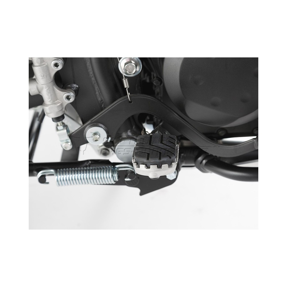

SW Mototech pegs, big bucks, but what you may want.
Could buy an insert and try to fit to the Kaw peg, they do sell separate. Or get a really thick heavy chunk of rubber and cut your own.

my concern with the really wide pegs is clearance between the peg and the shifter....already borderline for me ergonomically in stock config.
does there exist something akin to rearsets for this bike to move them back a hair?

I don't have an answer for that. I don't know where my KLX250 OEM pegs are so I don't know if there is the possibility to trim those rubber inserts down and fasten them on the OEM pegs, but that might be possible.
One other option is to buy the KLR650 OEM pegs, they are rubber pegs. If you look at accessory pegs and they show the KLR650 and KLX250 on the same part number that would mean the OEM would fit your bike.
