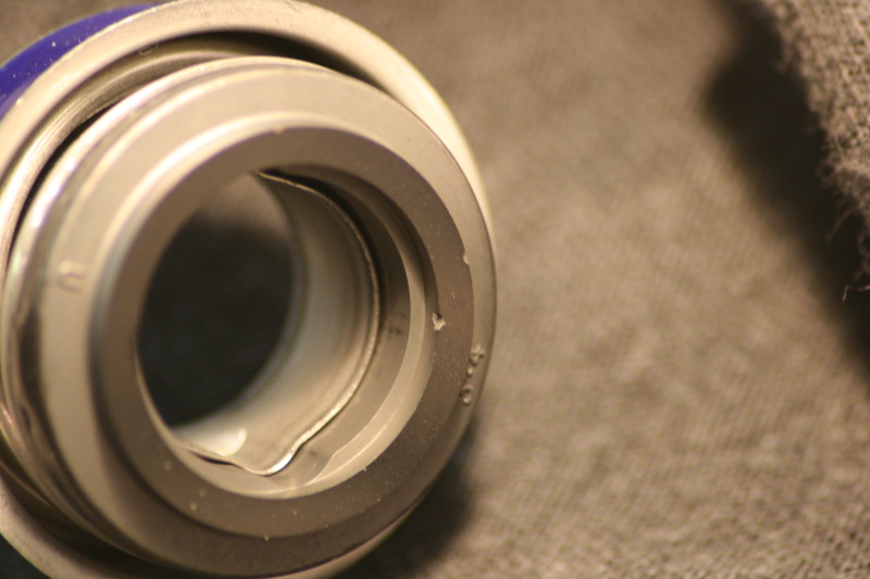

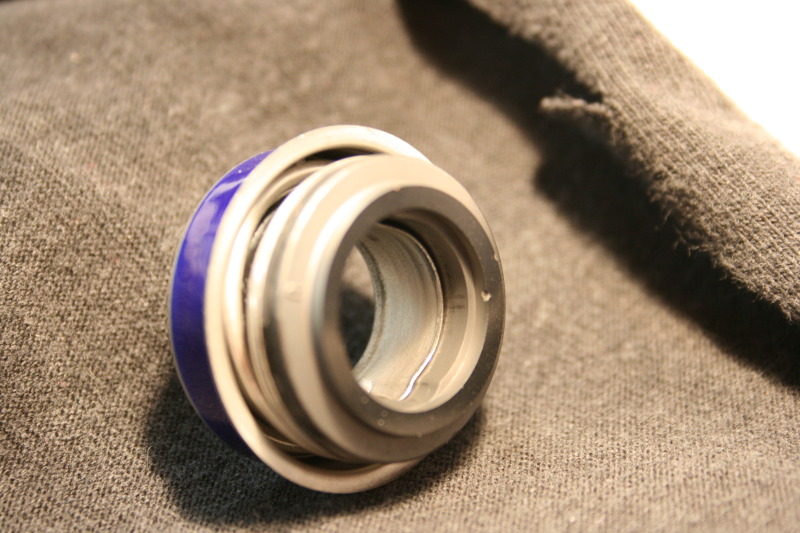

So i get a box of bearings and seals from RMATV today. Super fast shipping and good prices, but upon inspection of my order, I find one of my balancer bearings has been opened up and cleaned off at some point, and then popped back in a bag without any protectant and taped shut with Scotch Invisible Tape. I ordered OEM Kawasaki parts to get exactly the right parts and OEM quality because I dont want to have to do this again any time soon. I call RMATV and explain the situation to the cusomer service guy. He talks to two different techs that both say this is common and that letting bearings sit like this is fine. I have no idea how long this bearing has set unprotected, and I disagree that letting them sit like that is "fine" . Every bearing manufacturer i looked at tonight contradicted what the techs told my customer service guy tonight. I also dont like the way the water pump seal looks, It has two chips in the ceramic sealing surface close to each other. I told RMATV about this too, and was told that that is common too. They did say I could send a pic of this damage and if it was bad enough they would send a new one.

On the ceramic portion of the waterpump seal, a picture would help.
Edit: I see your pic. Man, how do these guys store their parts?...in a polishing tumbler machine?

I think it's bs. Poor customer service. If you were standing at a parts counter and they handed you those would you buy them? They are trying to get you to keep them as it costs them nothing. I would not spend my time installing known inferior parts and then hope nothing bad happens. If they don't want to replace them (not that I would really trust the quality of the replacements), tell them they are the wrong parts and you want a refund. They are "wrong parts" because they are "crap parts" and you paid for "new parts".
I'm with Lotrat on this one. I don't know what their return policy is, but if they won't replace them, I'd be trying to return them and buy somewhere else. It isn't like you're complaining that someone opened the packaging on a set of levers, or a piece of plastic. This is a lot more serious.
I called RMATV today to see what was going on with the two items I was questioning. ( they were supposed to call me yesterday) The same guy I talked to Wed. told me today, that they were going to replace or refund both items, whichever way I wanted it. ( the seal they sent me was their last, and the new one would be back ordered ) I told him to go ahead and order me some new parts, I can wait.
I have always had good experiences with RMATV so the initial refusal to cover the questionable parts threw me off. After today's phone call I think they have redeemed themselves.
