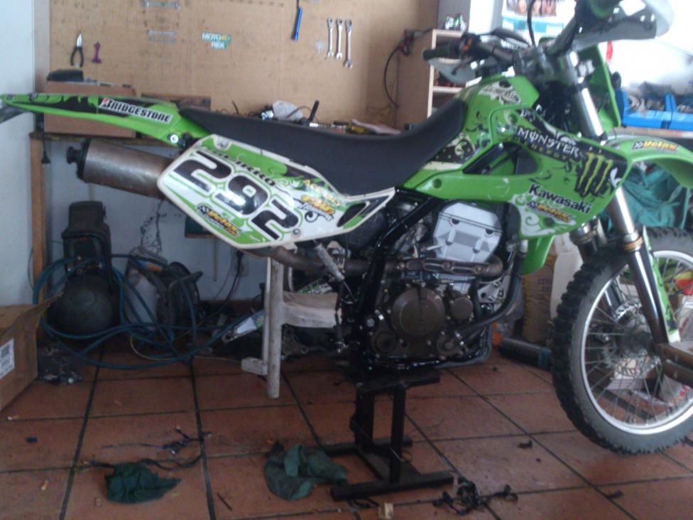

 report: CDI modification-img-20150130-wa0000.jpg here is my little half finished
