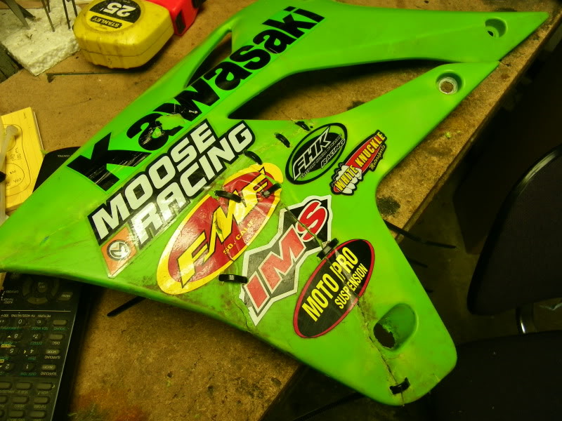

OK well seems any type of melting ( or gluing I'm sure) is a temporary fix. Once its broken, it doesn't take much of a hit to re-break a repair right on the same lines. All it takes is one nap and your hard work is ruined. The franken stitch may just be the best way. Doesn't look tooooo bad and it will flex when impacted.
Dan

Neil that's a nice clean repair. Looks like it will hold up to some crashes too.
