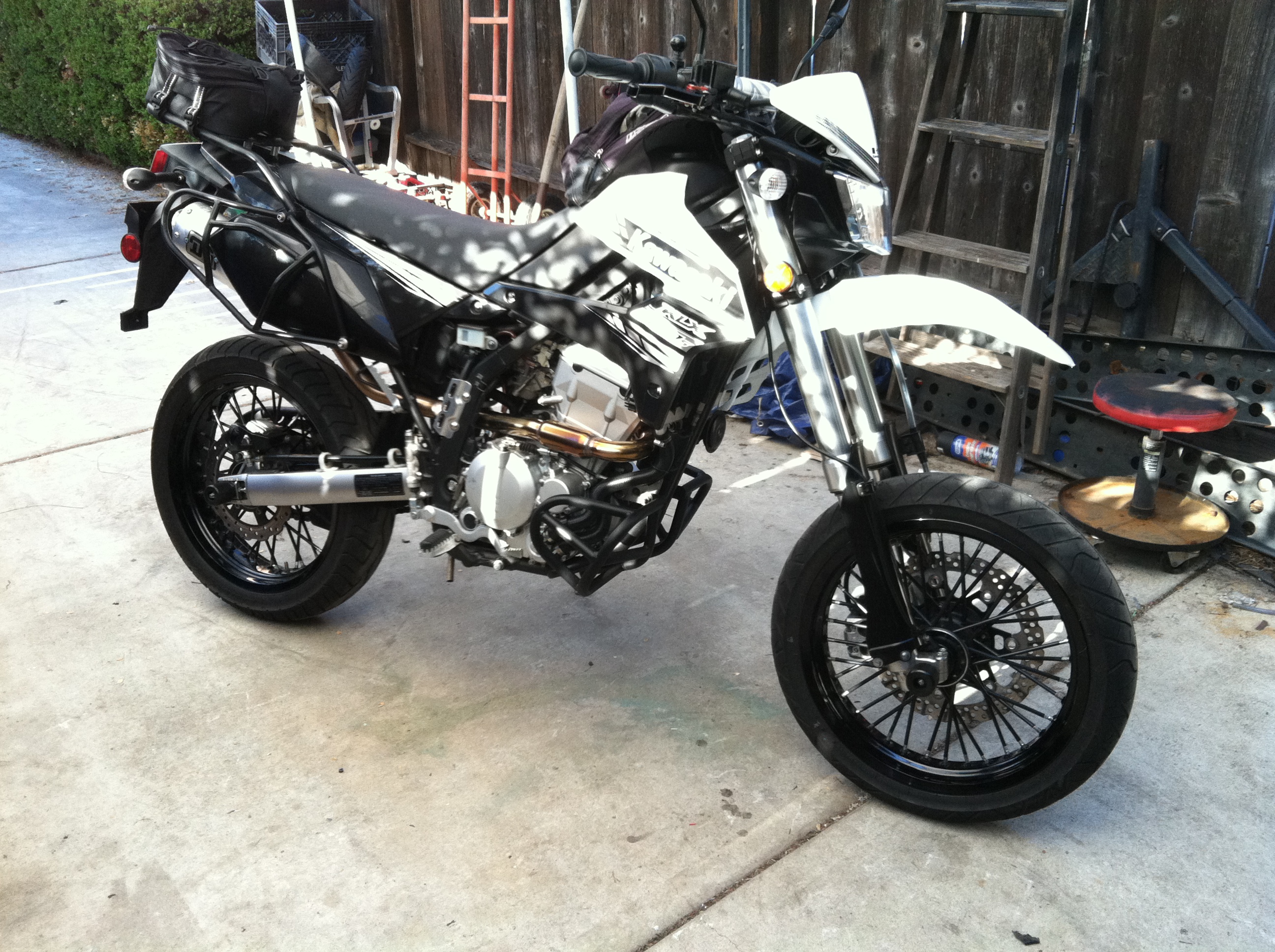

I have full racks
and still only 2 bolts to remove and seat comes right off
Old Jul 15, 2015 | 03:24 AM
2wheeler's Avatar
Joined: Jun 2015
Posts: 49
Those are the racks I have, which 2 bolts do you remove?
Old Jul 15, 2015 | 03:40 AM
MikeW's Avatar
Joined: Sep 2012
Posts: 434
From: Sandy Eggo
the ones where the rear rsck ties into the side racks
or if you look at the seat
the back 2 bolts on the side of the seat that the racks connect together with
