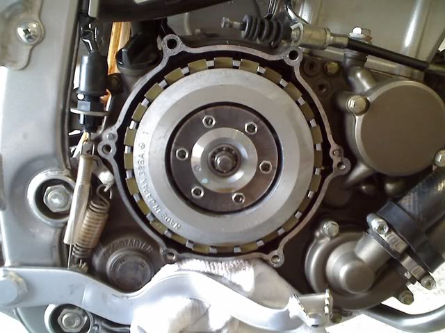

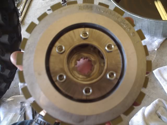

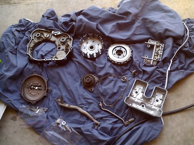

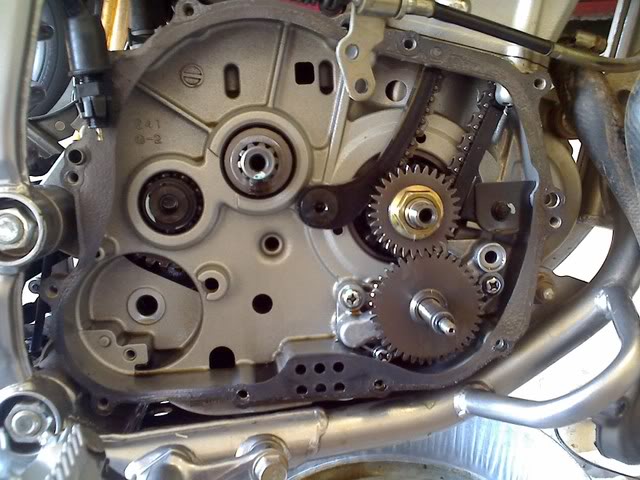

Yes, you can remove the clutch without the flywheel holding tool. Just put the bike in gear and remove the center bolt.

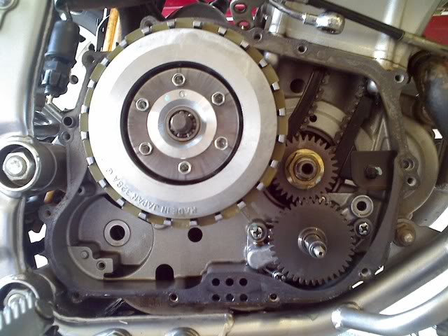

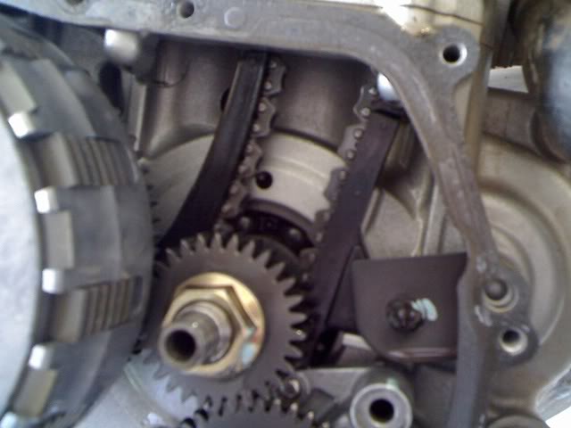

It is this nut that requires it.

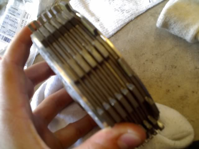

Clutch parts:

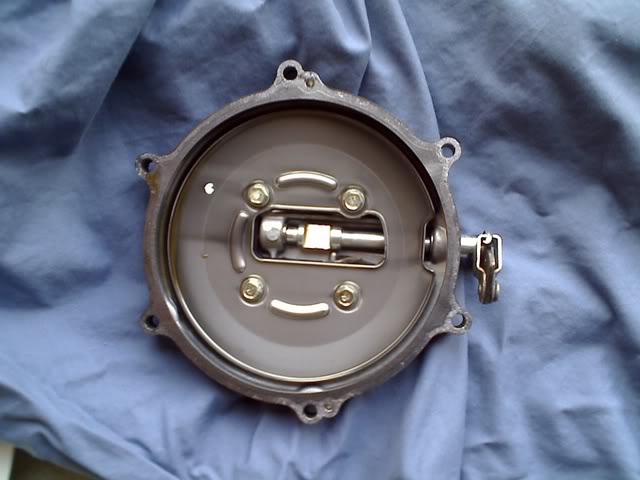

Also, you don't have to take the whole engine case siding off. Just the clutch cover.

Good pics but I am not sure I follow. In the second pic you noted "its this nut that requires it" Is it possible to put a socket on that nut and hold the crank while you back off the bolt in the basket? I assume you are not posting that the nut in the photo is required to be removed to remove the clutch basket or your last post about only removeing the clutch cover woud not make sense.

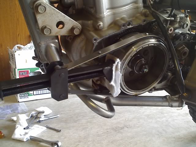

What I refering to, is the nut on the crank is the one that is required to use the flywheel holding tool to remove it. It is not required to remove it for the clutch only. As suggested by Gany, you can use the flywheel center bolt to help prevent the crank from moving.
Clutch removed with nut still on the crank:
FYI: If you do want to remove it. I suggest using an impact gun to get it off. Pain in the butt when I did it.
Flywheel holding tool:
