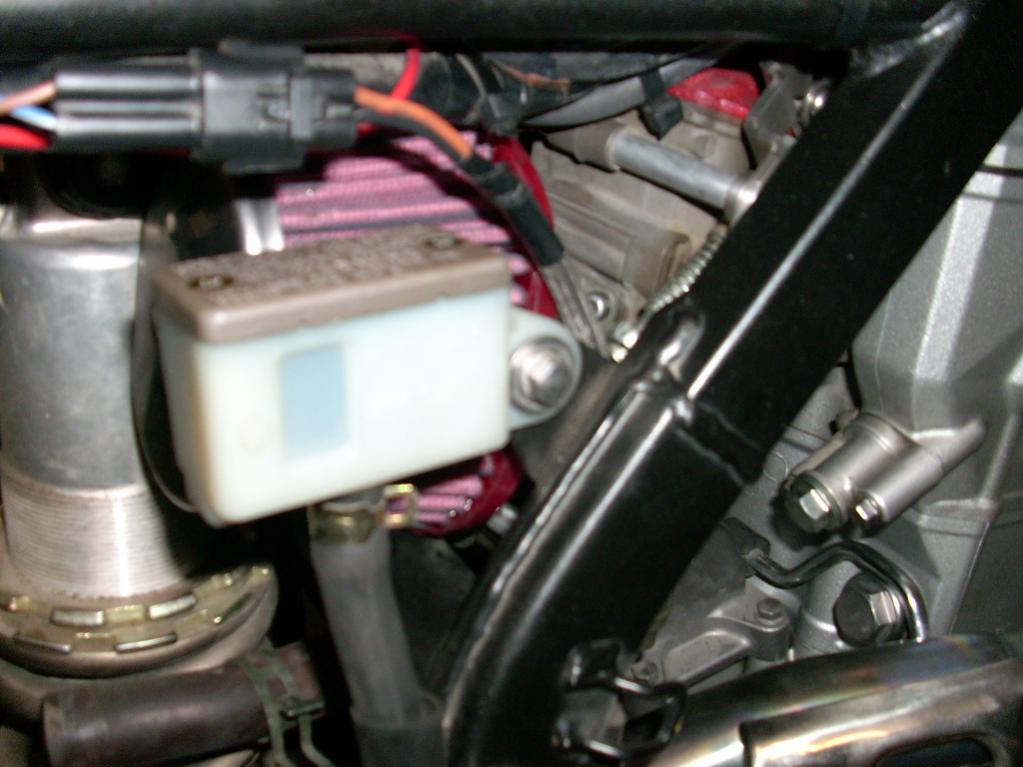

Originally Posted by Dready
alright! its gonna be done!
Gonna be done? I have a BMC filter on my D-tracker. Airbox is completely removed. The intake noise changes from mellow to a bit raspy. Whatever filter you get needs to clear the top of the cross member immediately in front of the carb intake. The filter you show might work. I used an oval-shape BMC with an offset throat. I'm pretty sure K&N makes the identical size and design.
