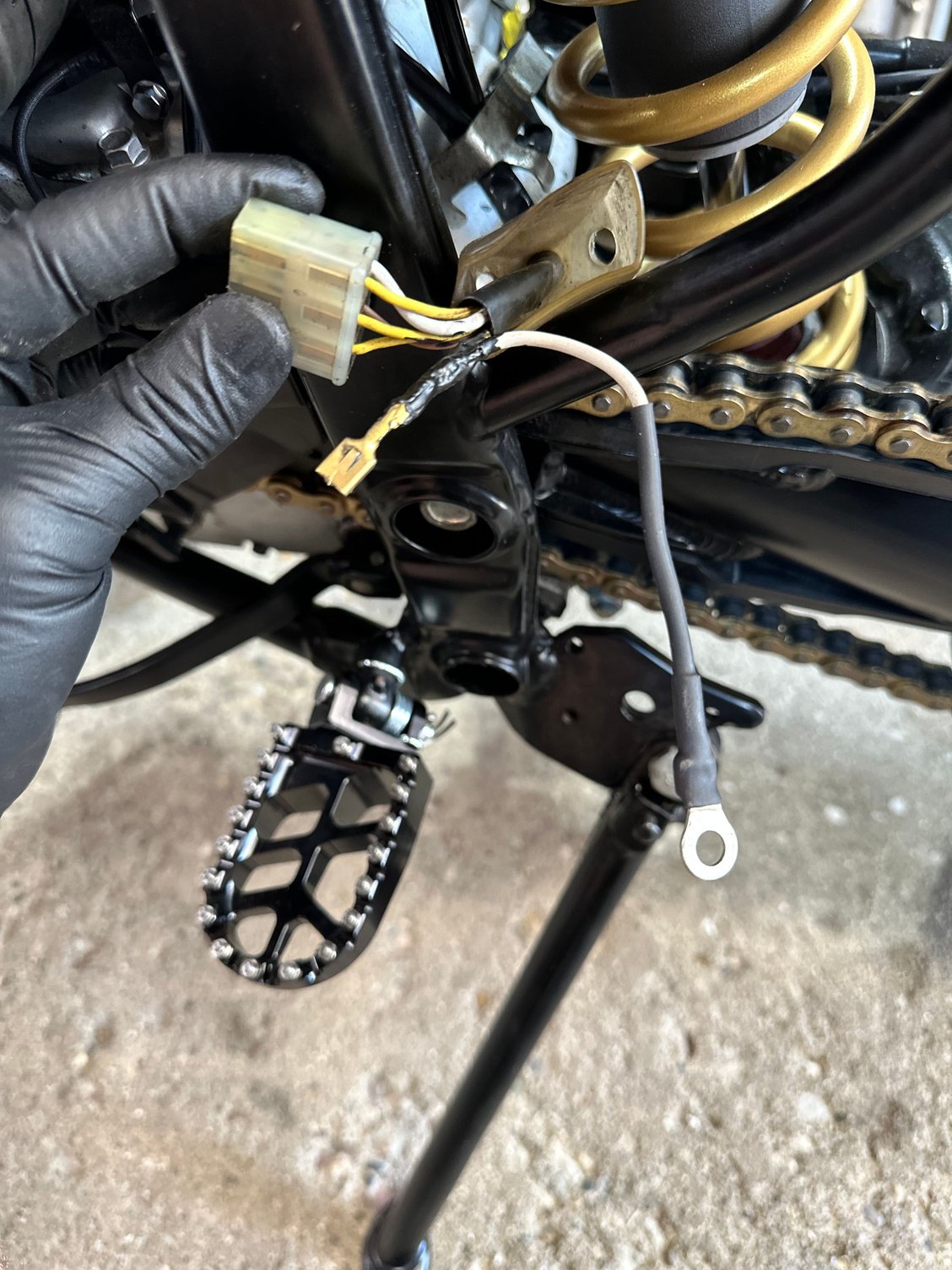

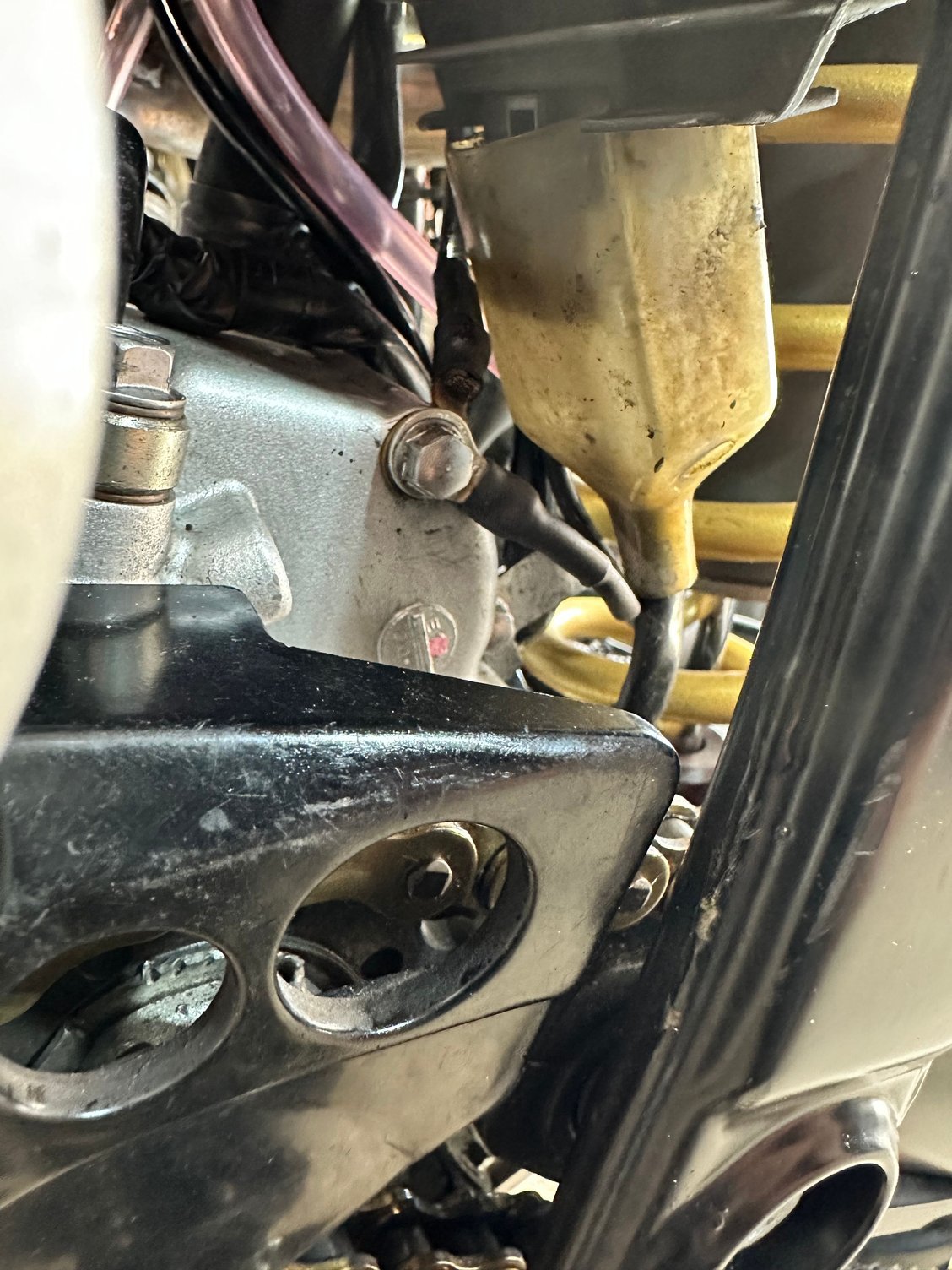

Was super confident this was going to fix the problem. Grounded the black/yellow wire on engine. Problem still persists irregularly.
On the test drive I was so fed up I unplugged the rectifier completely and the problem went away 100%.
Went home, ordered a new rectifier. I didn’t go OEM but did do the ricks rectifier.
Put the new rectifier in and same exact thing happened. Stutter irregularly while 40+mph-ish
Ran the bike without the new one plugged in at all and problem went away 100%. Bike idled better. Ran through all gears and rpms perfectly.

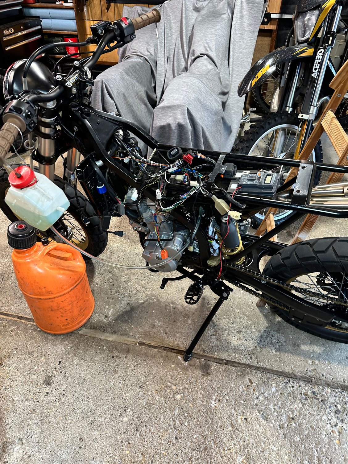

im stumped now. Only bad thing is I touched every wire on this bike when I built it. It’s kind of a custom KLX build. I could have messed up something along the way as I built the bike ~7 years ago.
I’ve now got it ripped apart and checking grounds and continuity across wire sections, everything seems good so far.
Pics for fun. Anyone have any ideas
Pigtail off the yellow/black to engine ground
Connected
Just put the bill blue pumper carb on it to try and fix the issue too LOL. Didn’t fix it but def feels like a different bike now. Way more grunt down low.
It looks like a rats nest but it was all bound and neater before I started taking off all the wire wrap.
