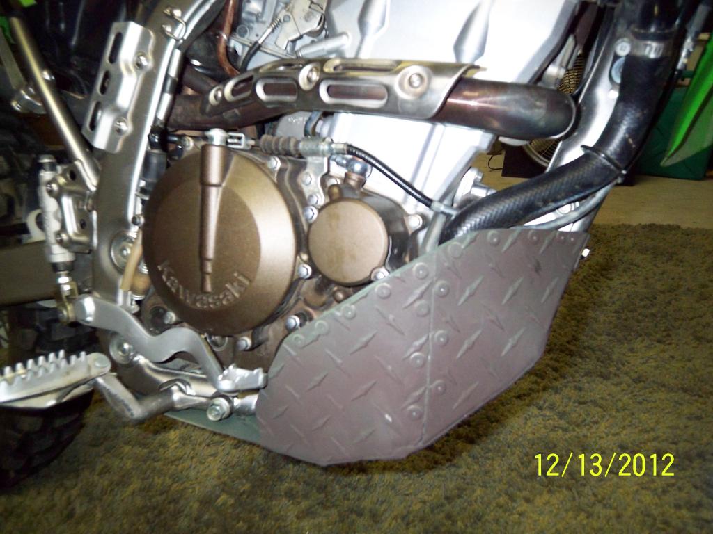

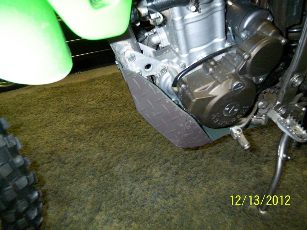

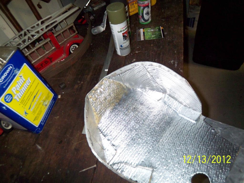

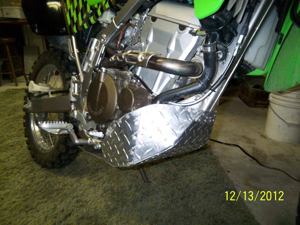

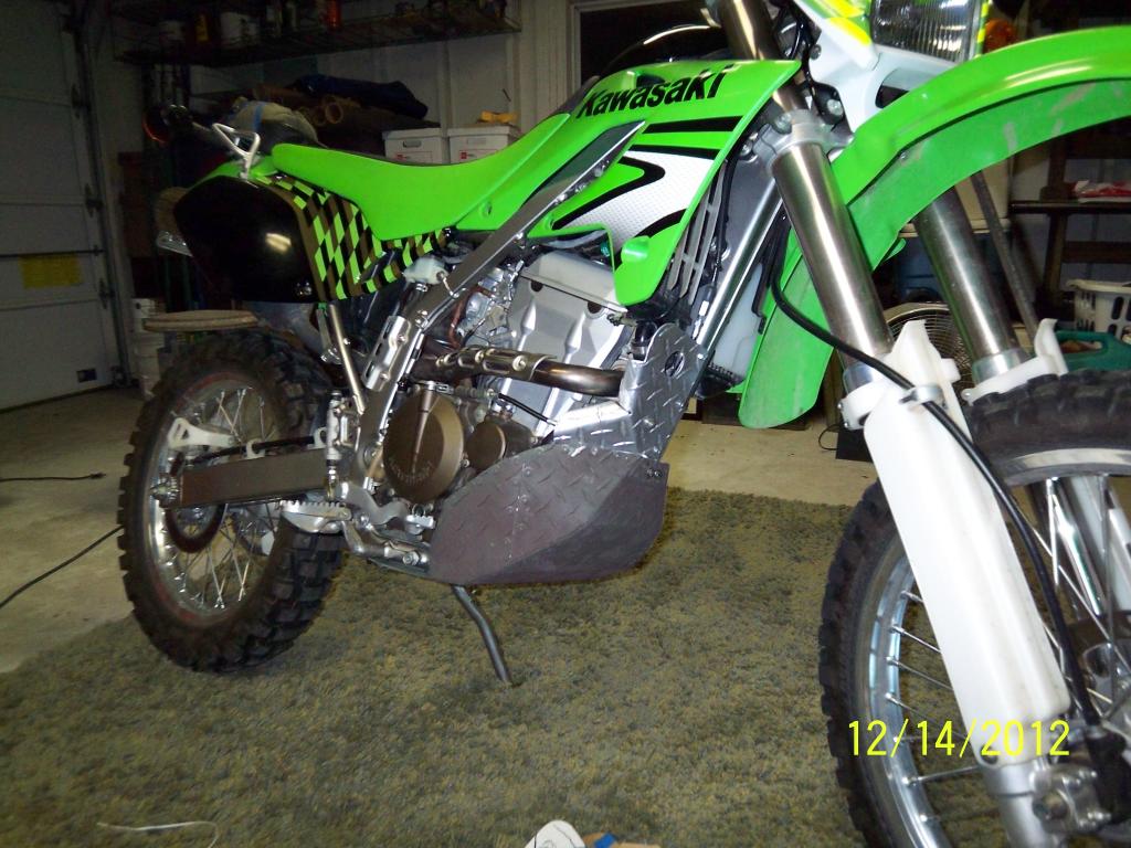

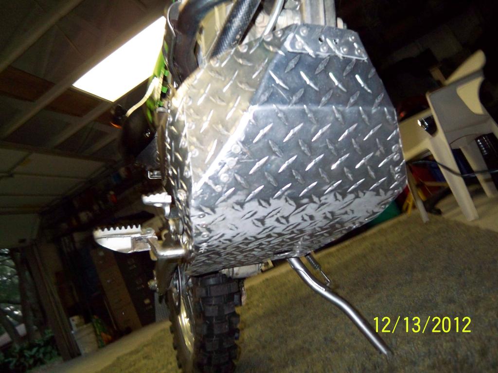

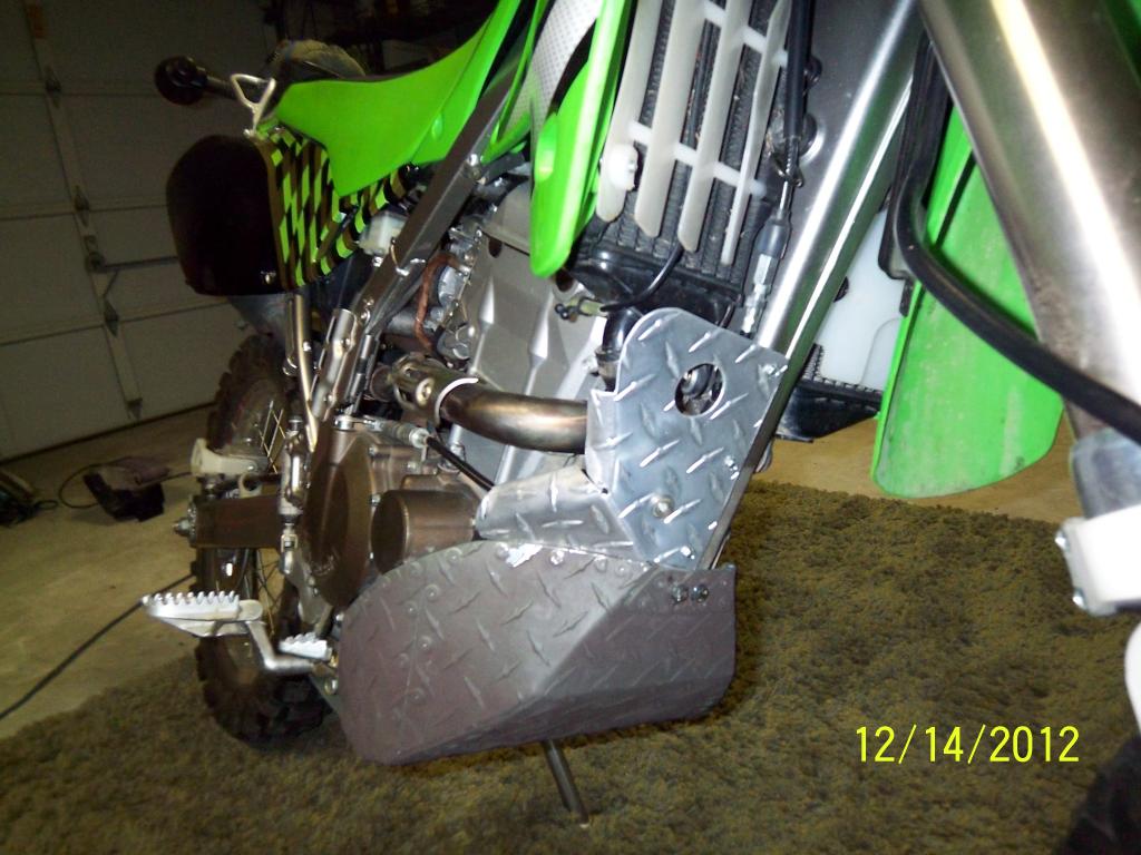

If there's two things us rednecks like, it's camo & diamond plate. I had a lot of fun with this little project & I think I'm going to keep going with an upper guard for the hose and clutch cable to the bottom of the rad. I used 1/8" alum plate with 1/8x1/2 reinforcement at the upper edges for added rigidity. I added a layer of peelnseal( bituminus sheet w/alum face for metal roof repairs) for vibration deadening. I peened all the pop rivets flat,and used silicone rtv to bond all pieces.I ended up with a cavity in front of rhe stator. I think I may try to fit a canvas snap lid over it and move the toolkit down off the fender. Then if I could come up with a good way to carry a water bottle, I'd like to loose the rack & address the turn signals. Anyway, like I said this really was a rewarding project, cutting paper templates etc. it was fun and easy.
marc

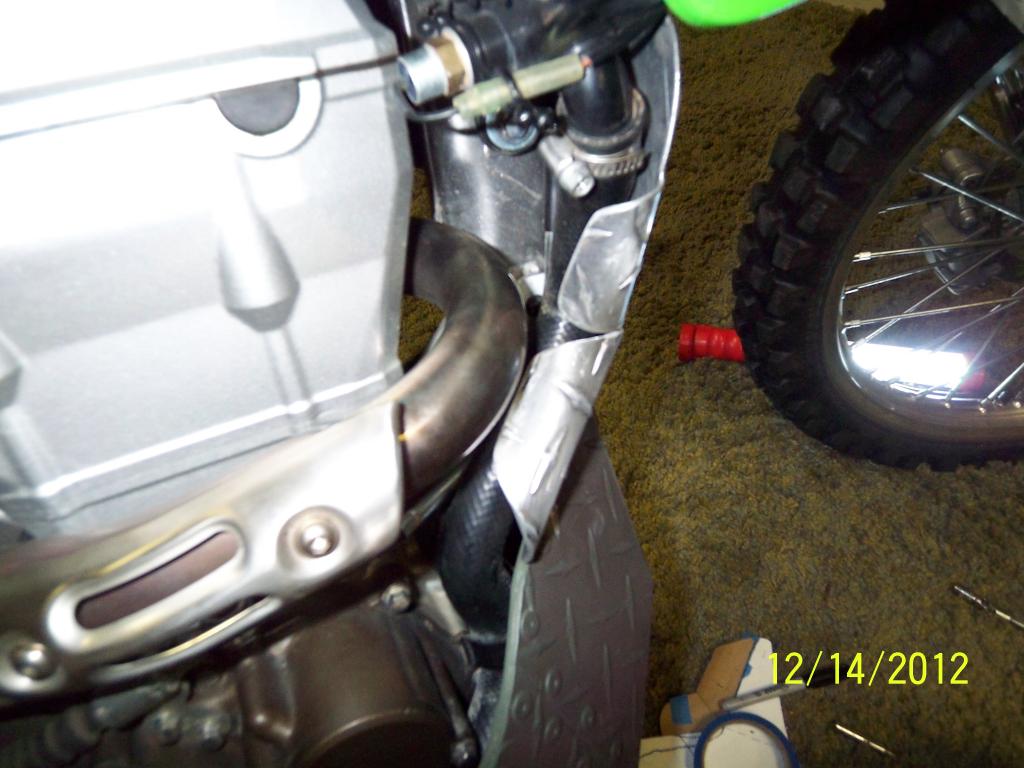

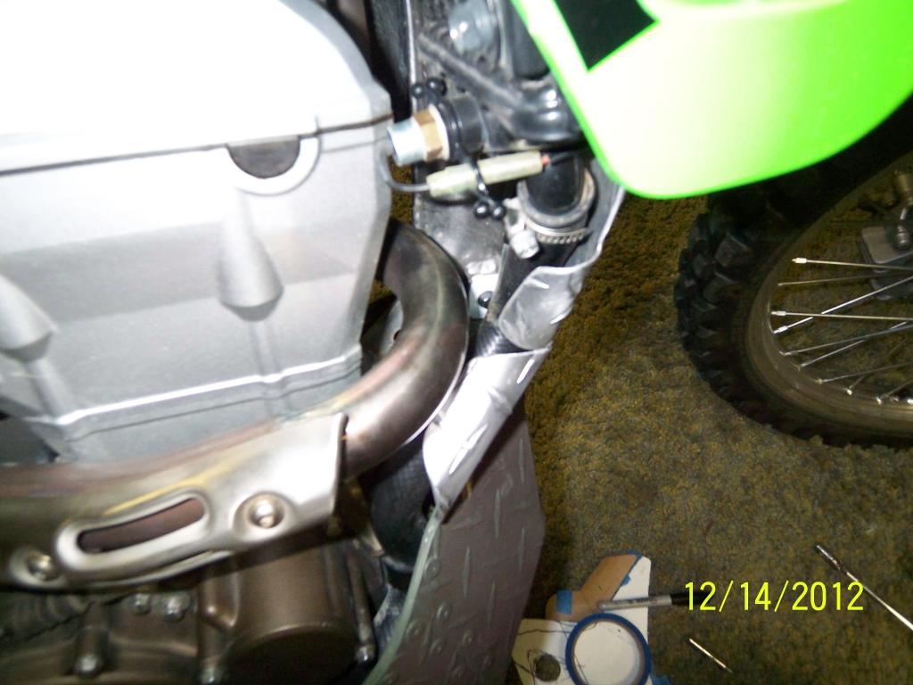

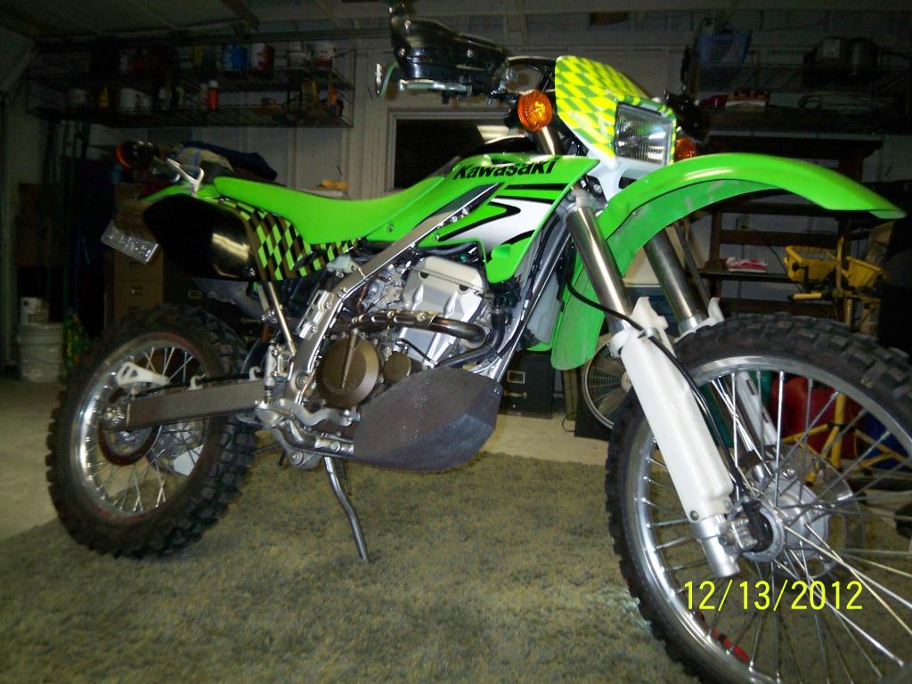

Thanks guys,I got to work on the top section today. I encourage anyone that doesn't have a plate to build your own. I haven't used a tape measure yet. It's all like " yeah, that looks about right". I like projects like that!

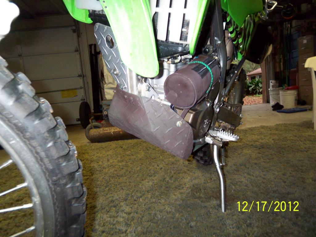

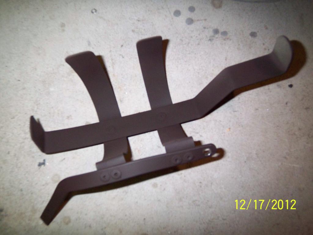

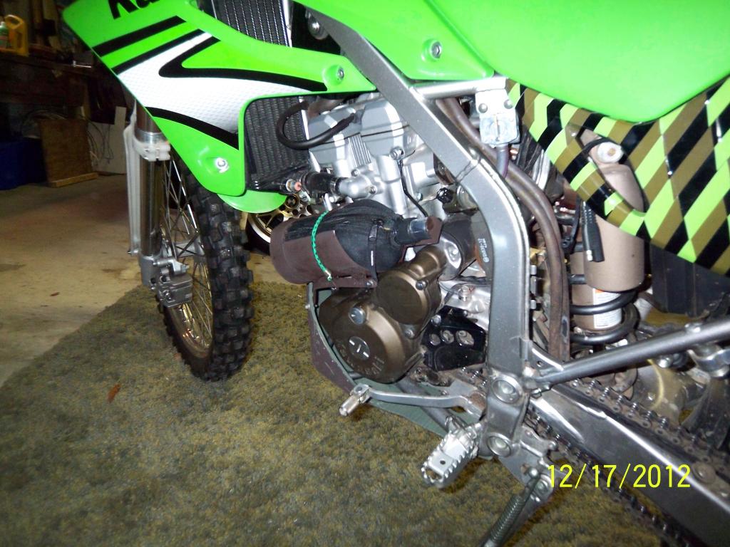

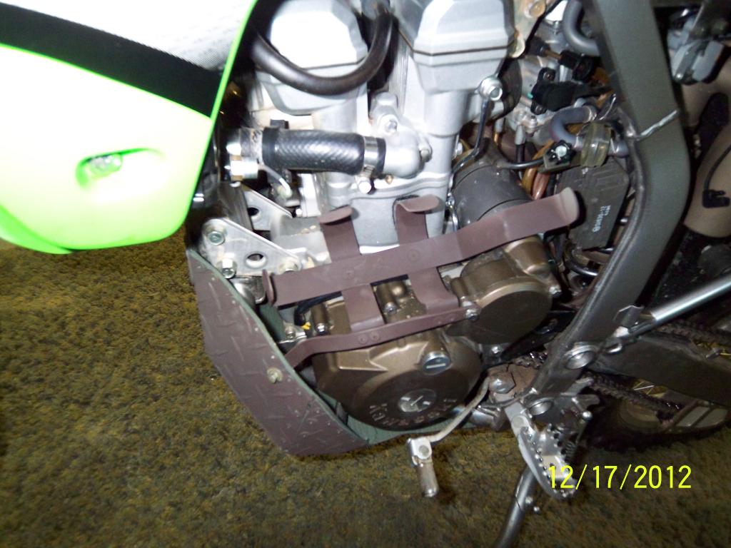

I've been carrying a old canteen on the rack,but hate the weight up high.
I found the perfect insulated 1 litre bottle called "The Fridge" at Publics grocery store for $4.
Daisy keepin me company.
