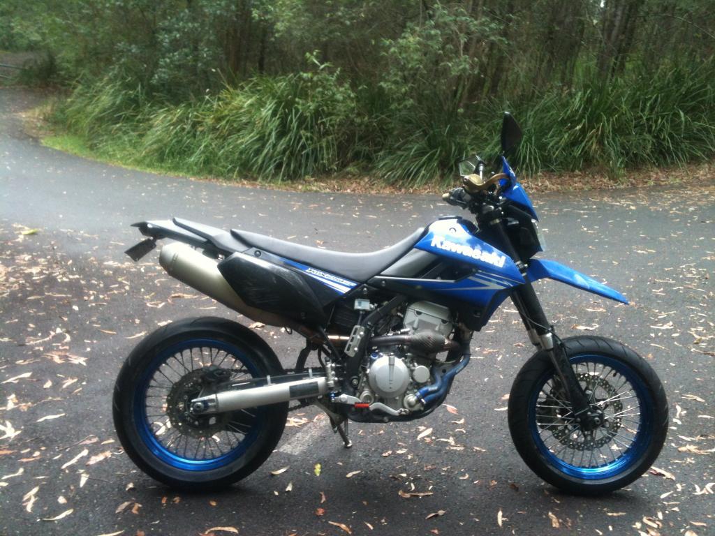

[QUOTE=250SM;497973]Diablo rosso 2 140/70 and 120/70.
Now that's what im talking about !
Exactly what I wanted to see, looks sickkk nice and beeefy
Do you think your tire set up will make my stock 250sf slower ?
