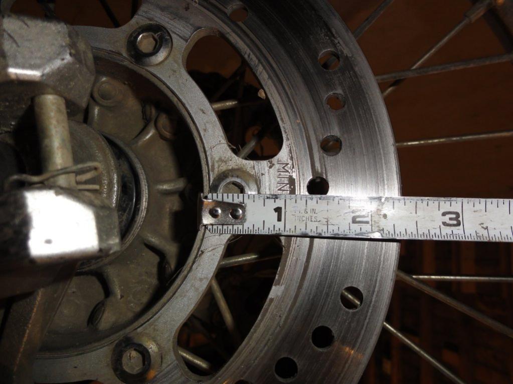

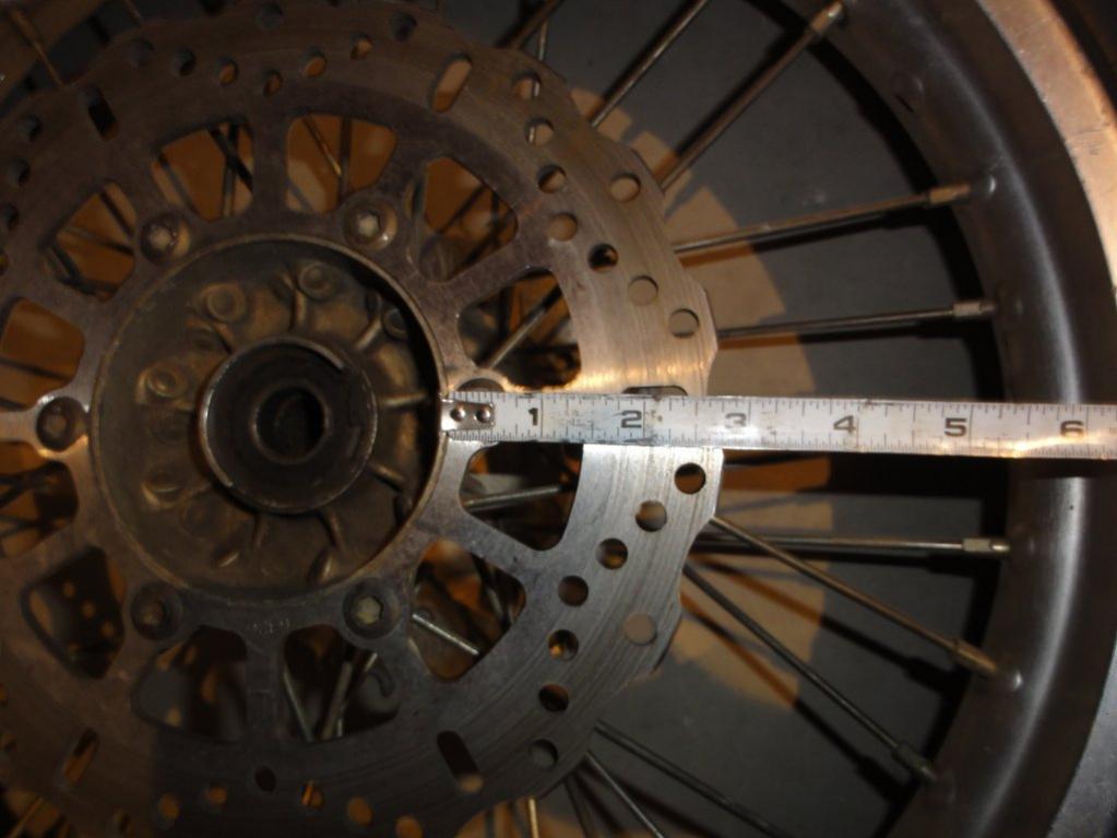

Here's the picture from the actual one (smaller) and the one that doesn't fit (larger)

My USA 2007 has a dimension of 2.5", just more confusion is all I see.

Your larger one looks like an aftermarket rotor'; or a newer than 07 rotor?

the larger disc looks the same as my 09
