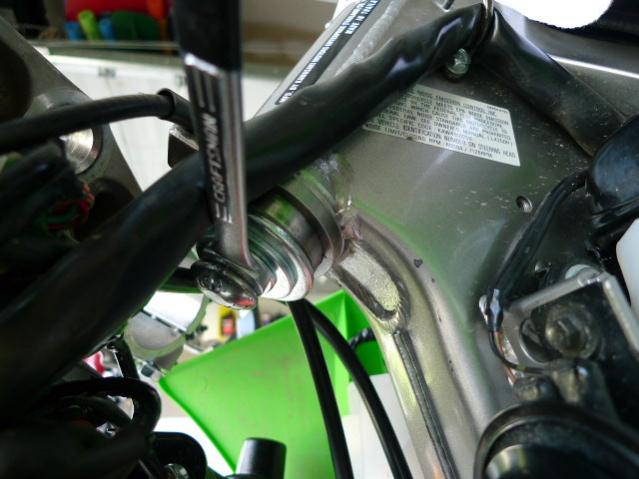

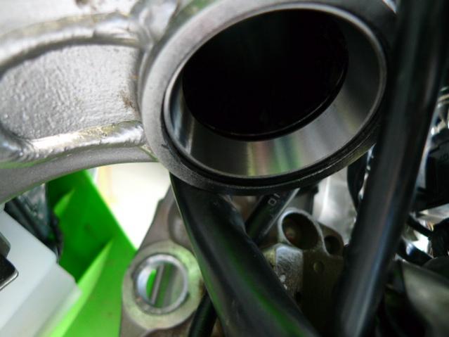

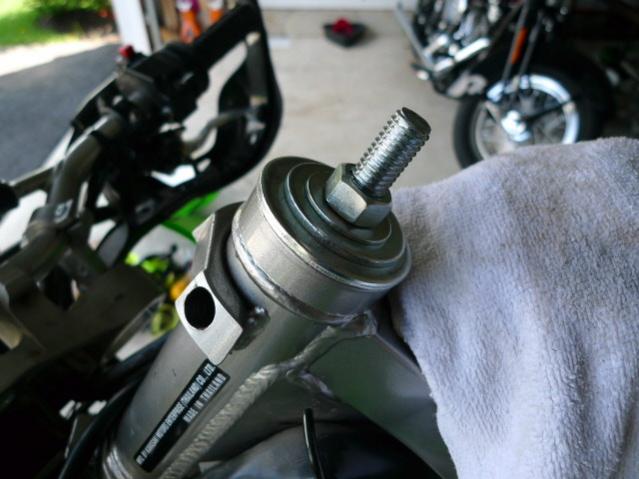

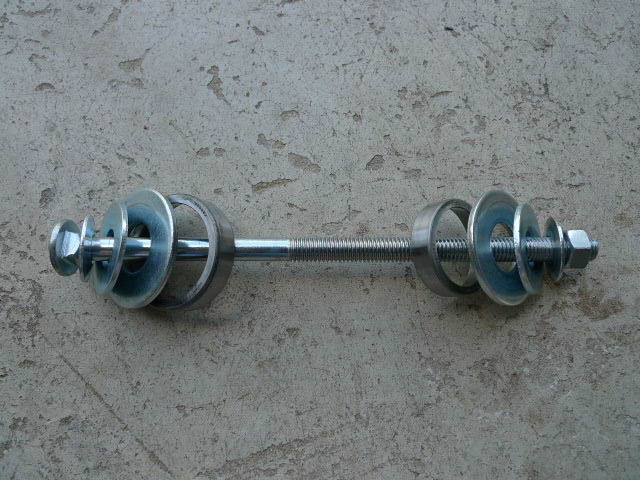

6. Hammered in new races as far as I could = flush with steering tube. I then needed to fabricate a tool to finish the job.
7. Went to hardware store and bought a 12" bolt and a bunch of washers - see picture - $8.50 and 10 mile round trip.
8. Used the old races with the home made tool to recess the new races - see pictures.
