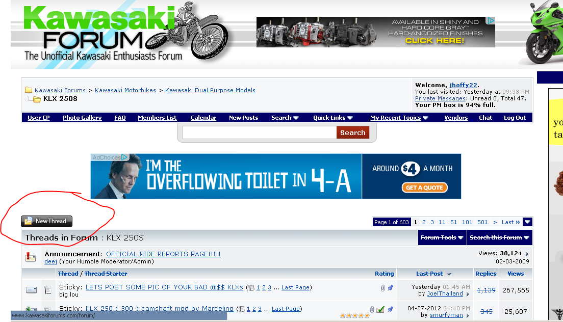

can some 1 tell me how to post a new topic its doing my head in thanks
Click there where I circled on the home page.
