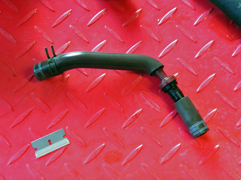

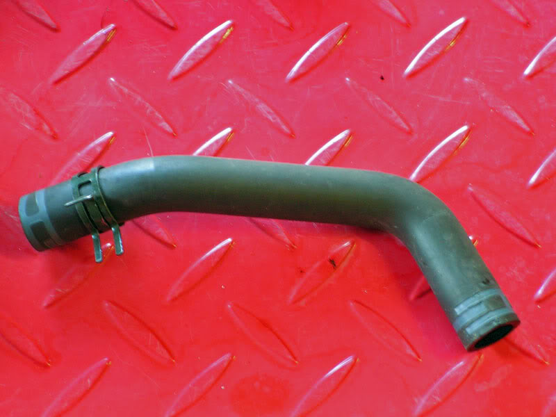

To begin the mod you need to remove the hose that connects the crankcase to the airbox on the KLX250S. Once off, it will look like this:

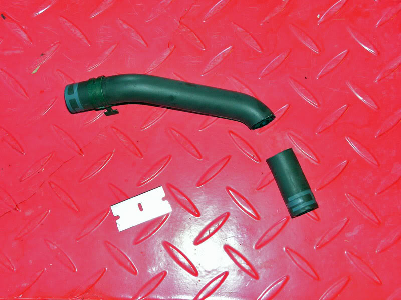

For the PCV to work properly, it must be oriented vertically. To make a spot to put it, I sliced the hose here:

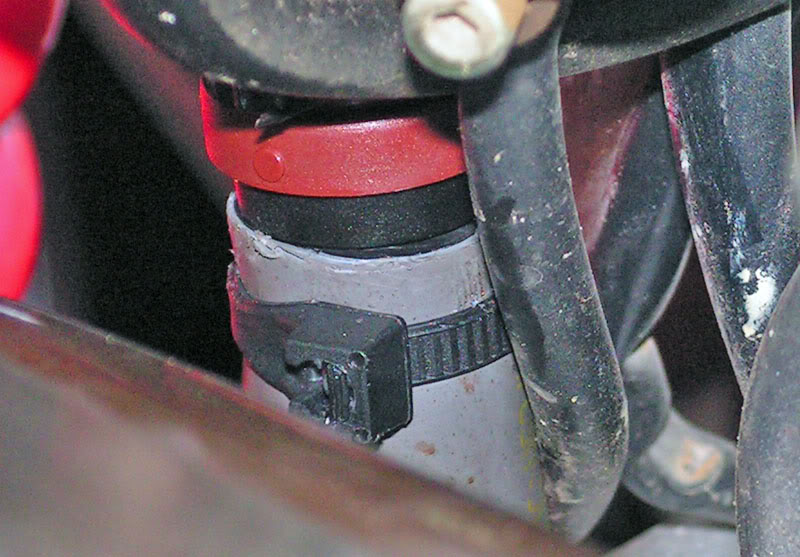

Next, I test fit everything and noticed that the top of the PCV valve needed a bit of and adaptor made.
So I hunted in the scrapbox and found a piece of gas line and cut about 1/4 inch piece and slipped it over the top end of the PCV. It fit like it was made for the job!
A couple of cable ties and the modified crankcase hose is ready to go back on the bike.
Here it is, back on the bike ready to be ridden.

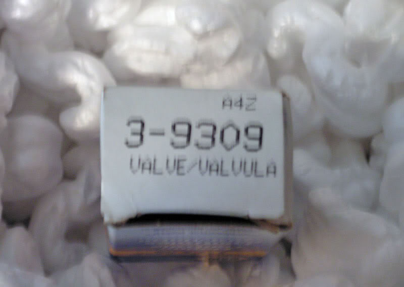

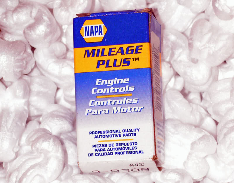

I started thinking about it and know that the part number is very important. Once again, thank God for living in a small town. I called my buddy and asked him about the part. We went down to his NAPA store, opened up the back door and went hunting. Matched the parts up and here's what we got:
And here what y'all are looking for . . . . .
