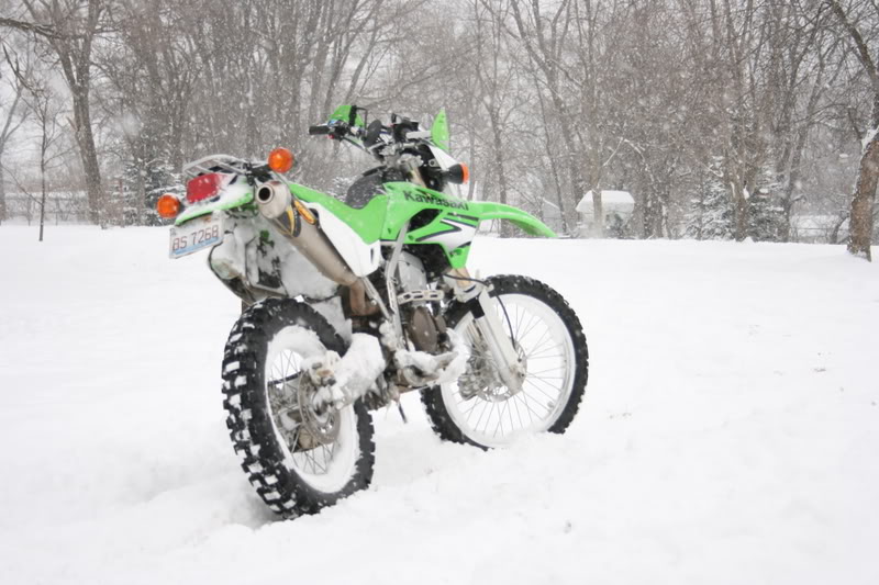

You've got a lot of riding season left!! I put sta-bil in my gas and put it on a battery tender. I start it (and ride it ) a few times through out the off season too.
