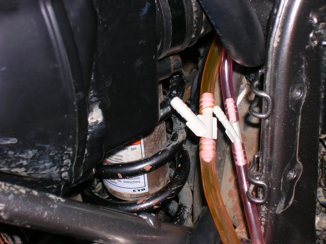

I just found this from Dirt surfers post....
Is the idea that the carb has a higher place to breathe from than the bottom of the vent hoses?
I know this sounds crazy but I don't have those hoses; I ran out of gas in the middle of the night and some guys stopped and let me siphon a bit but I was frantically searching for some hose and grabbed those. In the confusion after the siphon I lost the hoses, but the bike started and ran fine so I forgot about them. So... that reminds me... were they for anything important?
Is it almost like I have the benefit of the T mod cuz the breather now isn't down so low?
I know, I know... but at least I'm not a doctor

The lower picture shows the vent mod half done. There needs to be lines going up under the seat to finish the job.

Yea, don't leave them open there. Also, you can tee into the lines closer to the carb if you prefer too.

Do those hoses have vaccum? Is the part going down going to suck up water if they are in the water?
I don't understand why instead of doing the T mod you wouldn't just route the hoses under the seat with nothing point down?
(I know there is a reason - I just don't know what it is...) Does it blow/push and then get backed up under water and for that reason having an alternate route under the seat allow it to work when water is up to the bottom of the hose?
