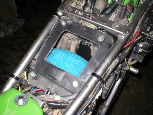

Speaking of airbox related stuff, my bike never came with a lid. Good lord it is load puttering at 60mph. Has anyone bothered fiddling with the lid to increase air potential while still keeping the noise down a bit?

didn't figure it would increase, but what if you cut out a bigger opening? should be a happy medium hopefully keeping noise down just a bit.

I think you can get a kdx 220 snorkel to fit and it has a larger opening and eliminates the grumble (i like the grumble) or you can just drill and put those plugs in.
Yeah, this is the direction I went. When compared to fully open and the lid still on but with a bigger hole, the lid-on scenario did take the edge off that really loud drone. It's louder than one with a snorkel, but this was as small as I was willing to go for air volume. It also acts less like an open bucket when mud and water try to splash up in this area.

That's even bigger than I had figured. Just need to find a lid now...
