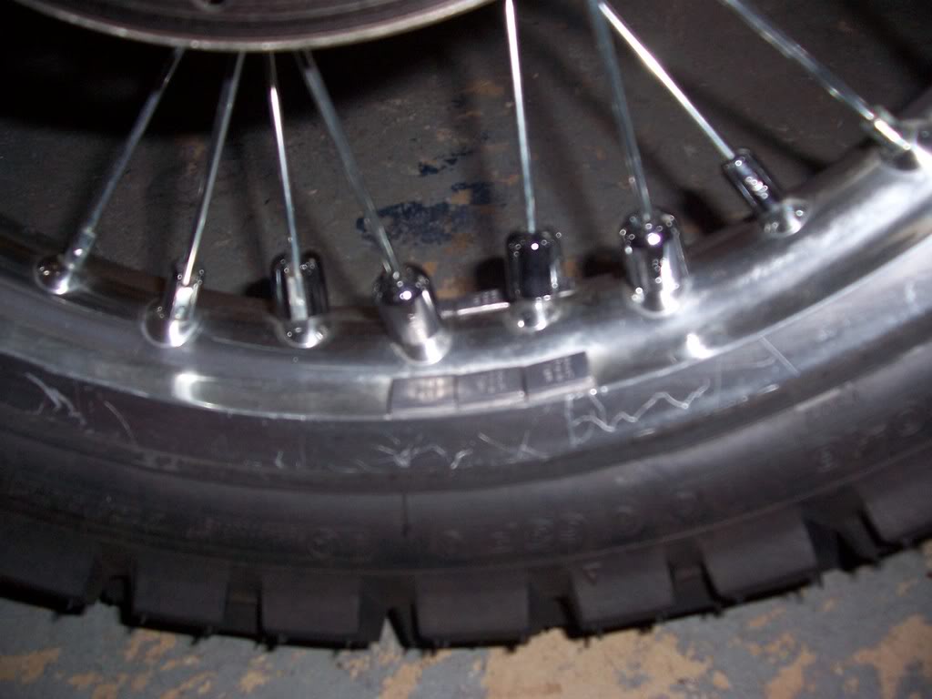

Spoke weights: 4 one ounce weights and 2 quarter ounce weights.
"stickey weights": 6 quarter ounce weights.
It takes alot of weight to balance out a rim lock.
I would suggest that you buy the spoke weights from Dennis Kirk as they carry the chrome spoke weights which look the best on a KLX rim. I have this set-up and am extremely happy with it. Very smoothe ride... I have the same rim lock as you and this worked out perfectly.
Mike

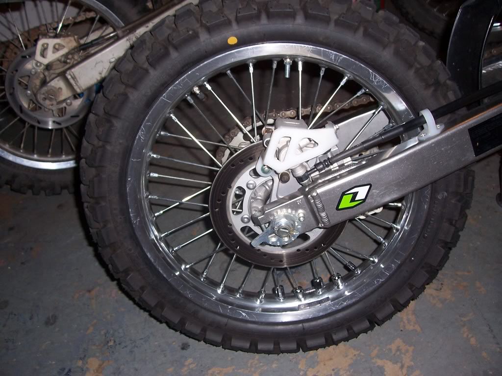

Pic 2

Jesus christ that's a lot of weight!!! But thank you very much for the #'s. So it's 6oz total on the back.. Good to know. I almost have that much, guess I need a little more..
